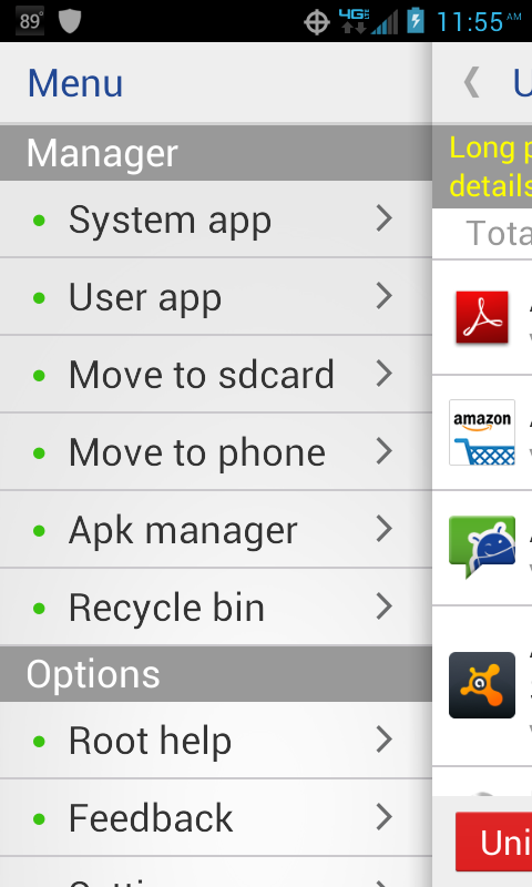

This is the app I have used before
When you click on it you access menu with upper left arrow

Click on recycle bin and a list of all the apps you deleted should be there

i Uninstall the app when it happend btw i reinstall the app ( System app uninstaller ) i check the recyle bin and Its empty nothing founded :(

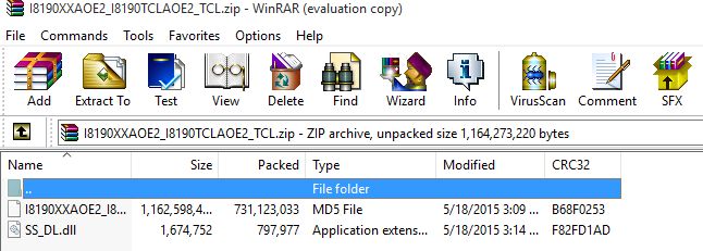

i download the firmware of my device how do i use it X_X ITs look like MD5 file format
Based on the screen shot, I'm going to guess Vodafone is your carrier and you are in Portugal (TCL)
As long as this is correct, and your model number is GT-I8190, this is the correct firmware for you device:
