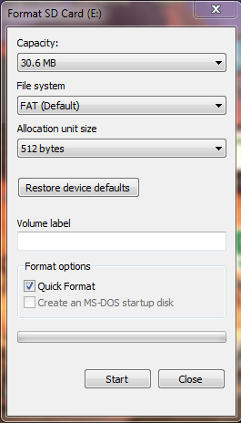

Ok ... tried that and the format window is showing the incorrect size for the micro SD card. The size shown is 30.6 MB instead of GB!!! ... pic attached

Does this mean the card is faulty and needs to be returned (hopefully can be)
Have you actually tried to format? h2testw won't read the card if it isn't formatted. Select FAT32, attempt to format and see if that makes a difference?
If it won't, I suspect the card is faulty and would need to be returned. If it's an authorised seller, you should have no problems getting a refund/replacement.
Does not allow me to format ... gave an error and now it gives giving the insert disc error, looks like the card is faulty and I need to return it.
