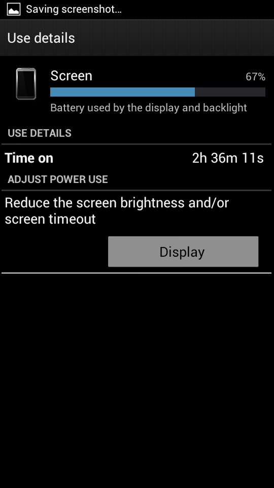

My Seidio 4000mAh battery was $52 and I easily get 4.5 hours of on-screen time. Most times with electronics, you get what you pay for. Most times.
Here's a couple of screenies
Unfortunately, "you get what you pay for" is true (most of the time :p). Well hopefully you can settle it with the seller but I wouldn't really call it a big loss.
