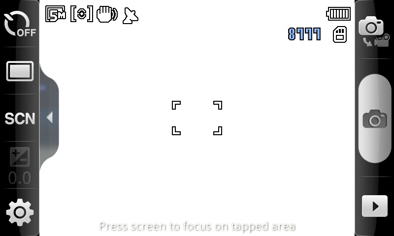

I don't see what he's talking about either. Correct me if I'm wrong but doesn't the Optimus V have a 3.2 megapixel compared to the Captivate's 5MP camera? I think he's seeing different settings since it's a totally different phone.
Here is what my camera screen looks like.
I'm running Official Froyo 2.2. My screen matches the screenshot posted. I can't find anyway to turn off the geo tagging either...:mad:
