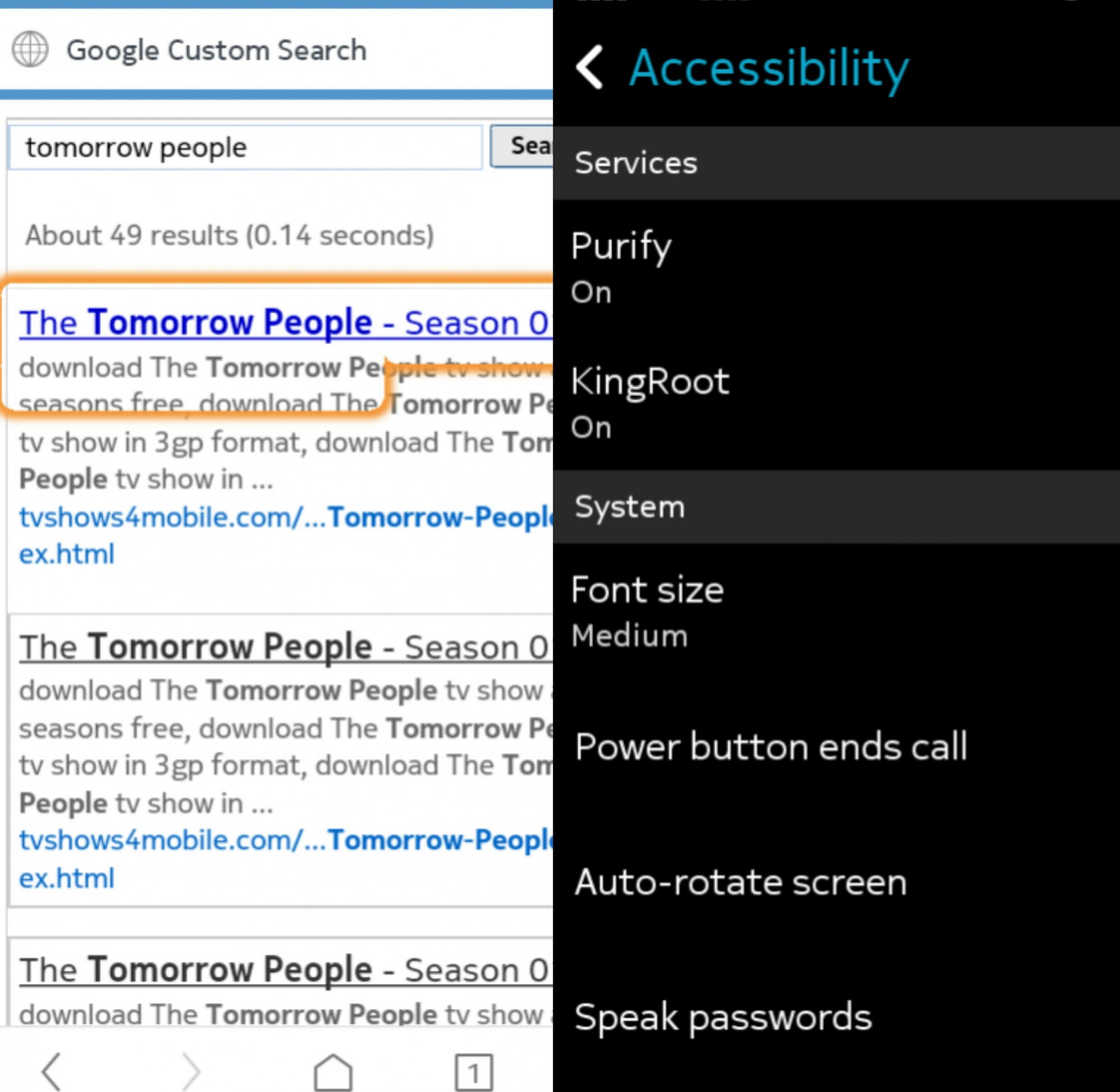

My mobile is Nokia X Unfortunately!
I installed the root, and the Google services... including talkback..
now my problem is that.. I did uninstalled the talkback.. but the virus kind of thing still exist.. It works only while I am browsing in uc browser or using tubemate, or vidmate.. it only appear there . that's very annoying..
The malware "virus" might have come from a malicious app sideloaded from outside of Google Play, i.e. installing from untrusted sources and whatever websites.
