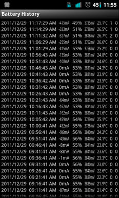

My best drain rates was 0.4%/hr(now 0.3*/hr see test below), but it's normally around 1%/hr, with no significant use. During normal work weeks I have a number of appointment alarms each day, although Calangoo does go silent during meetings marked as "busy".
One interesting note is that I bought Juice Defender Ultimate, but found I was able to manage my battery better by hand. I decided that the ONLY feature I wanted was to turn off my wifi with the screen, but JDU wasn't all that good at it. I also tried Battery Defender (after seeing it here on someones post). It seems like PD has an option for what I want, but it was unable to manage the battery any better than I can by hand, and seemed to make matters slightly worse at times.

Multi-day test in progress:
I took the phone off power at 12/30 0930. I'm now over 3days unplugged and displaying 18% battery. When I looked on morning of day2 I saw a 0.3%/hr after the overnight period.

  • Looked through logs to find real on battery start was 0930 (took screenshot)

Calling it done well over 75 hours on 1/2/12 at 1315 with (4% battery)
I think three days, two nights is a full three day test. But when I had 24% battery after that time I thought it might be nice to go the extra night just to see the 3d status on the phone.
Two things of note:
  1. BatteryMix logs show I was off power by 12/30/11 0930. When I checked the morning of day4 around 1/2/12 0930 I was surprised to see "Battery usage" showing it was NOT already 3day (it wanted more than another hour)? Where am I loosing time? I believe BatteryMix because all of it's data seems to match up and meshes with my memory of what occurred.
  2. One more thing that I've noticed over time is that the app shown as the biggest Battery user is frequently wrong. Or at least there is no additional data supporting the accusation. It seems like an app is sometimes given credit for all of the OS activity. On my test the falsely accused is Gallery. I did use the app a number of times, both to change my background and to check my screenshots. But it was NOT running most of the time and all of the BatteryMix graphs indicate it was not consuming the power that "Battery usage" is claiming.
