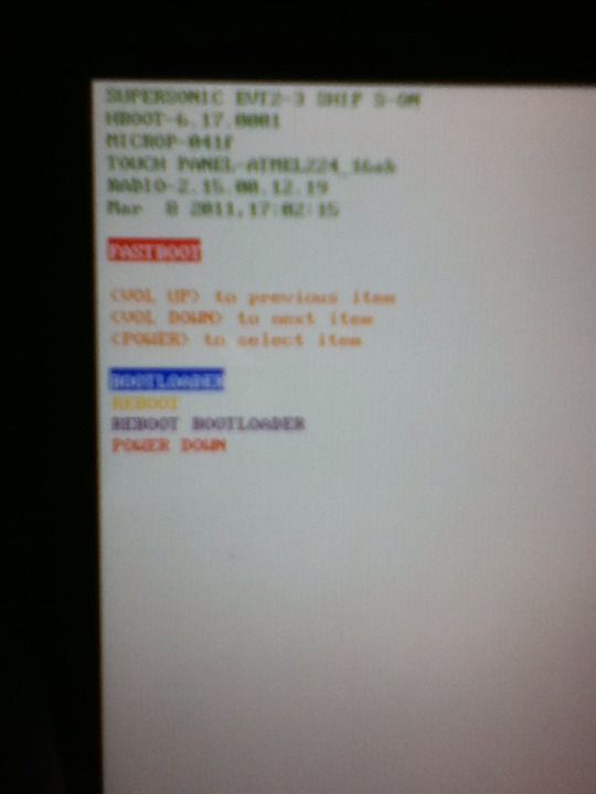

Root Does anyone have the stock Evo Rom that is flashed though bootloader
Okay we'll basically I'm unable to use my recovery for some in un-known reason (I have tried switching) and yeah so this coincidently happened as I wiped my phone and was about to flash a rom. So yeah only thing I can use is boot loader and I know I can flash a stock rom from bootloader using the PC----.zip format. I already have s on by using a file that I flashed through bootloader so I just need the stock Evo rom in the pc----.zip format for bootloader. PLEASE HELP

My S is on because I flashed something in bootloader to make it come back on
another thing that may help is a "getvar all" that will show us more clearly your main version(critical in finding an ruu),as well as the bootloader version,etc.

The only problem is it isn't reading my SD card still like it wouldn't in recovery. It's also not letting me charge it unless its off.
It is readable by the computer when I put it into a different phone. It is readable by the phone but just in bootloader or fastboot. It didnt work when I had to flash a recovery to get a Rom back on my phone so that is why I wanted to unroot. However my phone doesn't charge when it is on also... I know what ever it is is a problem with the phone drivers or something in that nature. It's not the factory Rom

C:\mini-adb>fastboot devices
HT07ZHL03201 fastboot
C:\mini-adb>fastboot getvar all
INFOversion: 0.5
INFOversion-bootloader: 2.18.0001
INFOversion-baseband: 2.15.00.12.19
INFOversion-cpld: None
INFOversion-microp: 041f
INFOversion-main: 5.07.651.1
INFOserialno: HT07ZHL03201
INFOimei: 355195000000017
INFOproduct: supersonic
INFOplatform: HBOOT-8x50
INFOmodelid: PC3610000
INFOcidnum: SPCS_001
INFObattery-status: good
INFObattery-voltage: 3871mV
INFOpartition-layout: Generic
INFOsecurity: on
INFObuild-mode: SHIP
INFOboot-mode: FASTBOOT
INFOcommitno-bootloader: 4b46e889
INFOhbootpreupdate: 11
INFOgencheckpt: 0
all: Done!
finished. total time: 0.010s
C:\mini-adb>
Scotty, would I read that right if I think he is now unrooted, s-on and on the stock rom software version 5.07.651.1.?
If so, and if he unrooted via the guide that Ocn linked, he wouldn't be on that version would he? Not to mention on that baseband.
Am I missing something or reading something wrong?
