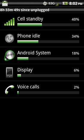

No, you don't need to downgrade NV. As for knowing whether or not it's working, I guess that goes back to whether or not this will even help. The main reason for doing this is if your phone isn't sleeping when idle. Despite what spare parts says, what do you see for wake time vs uptime in the battery settings page? If it's higher than what you think it should be, than this might help. Same goes if the battery is draining a lot while the phone is idle. If you downgrade, and it helps, you'll know, more than likely, if the battery doesn't drain as fast when the phone is idle. If the battery is just draining quickly only while you're using the phone, this is unlikely to help.
im not in spare parts now, just regular settings for battery, uptime-20:53 awake 4:37.. i dont know why voice calls is in there i havent called or recieved since this morning, then trying to calibrate battery to kernal some how?

Well when its charging i check battery monitor now and then to see where the % is if it will ever go to 0, justlike now i was at 72% in last screenshot now im at 66% within (EDIT 10 mins ) in the market. when unplugged it will drop down to 96% with in half our from 100% without using it, but i think it drains faster when in use such as txt,market,emails ( not alot of txt )

Yeah, that does seem like quite a bit of time since last unplugged. But is that 8 hours idle, mostly? If so, that's not all *that* great.
