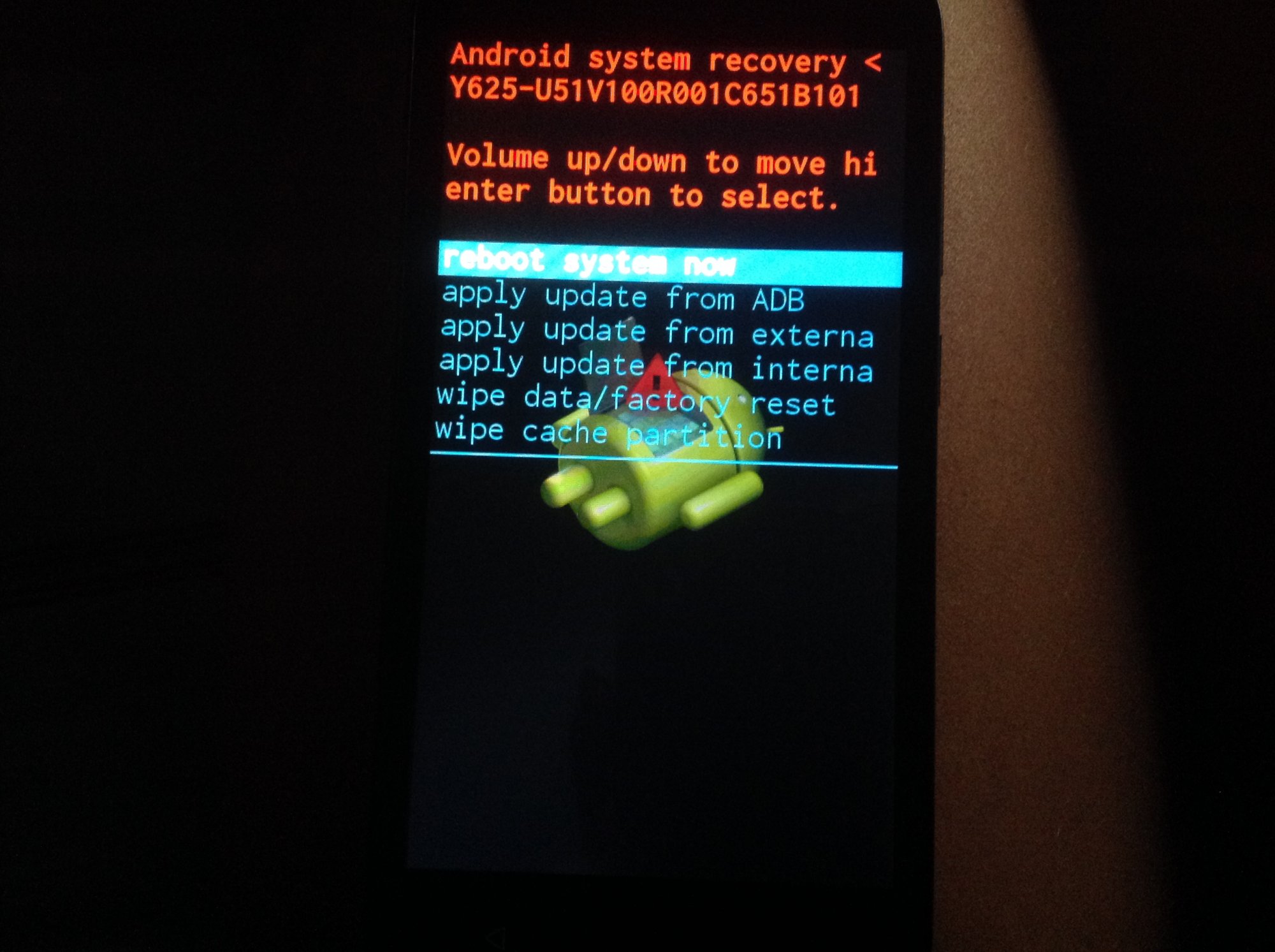

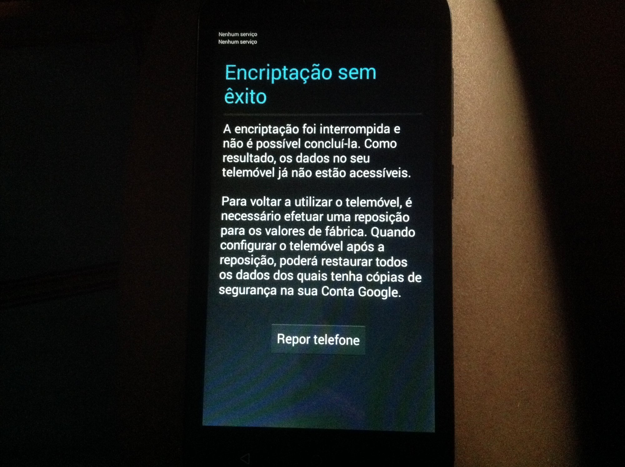

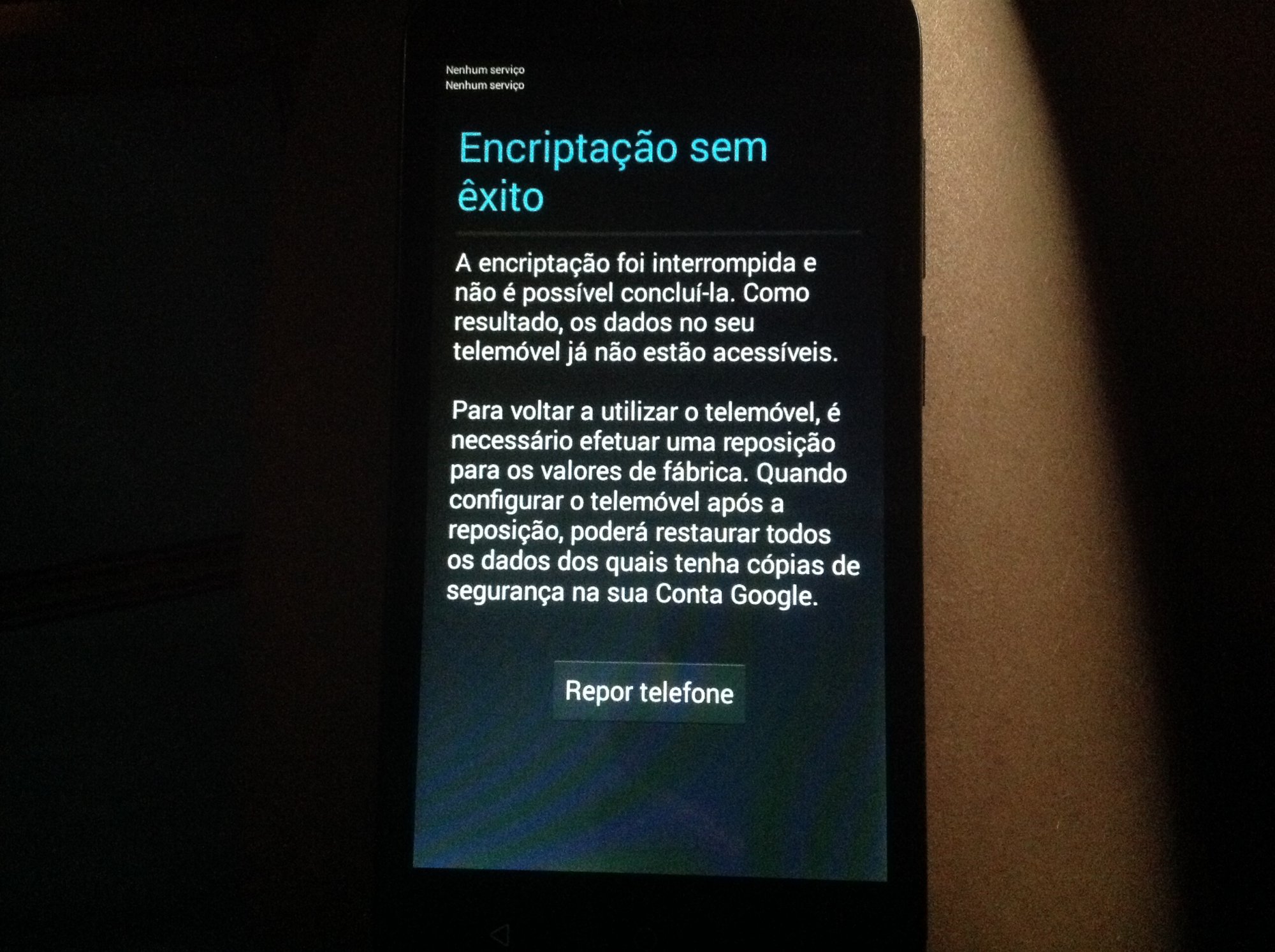

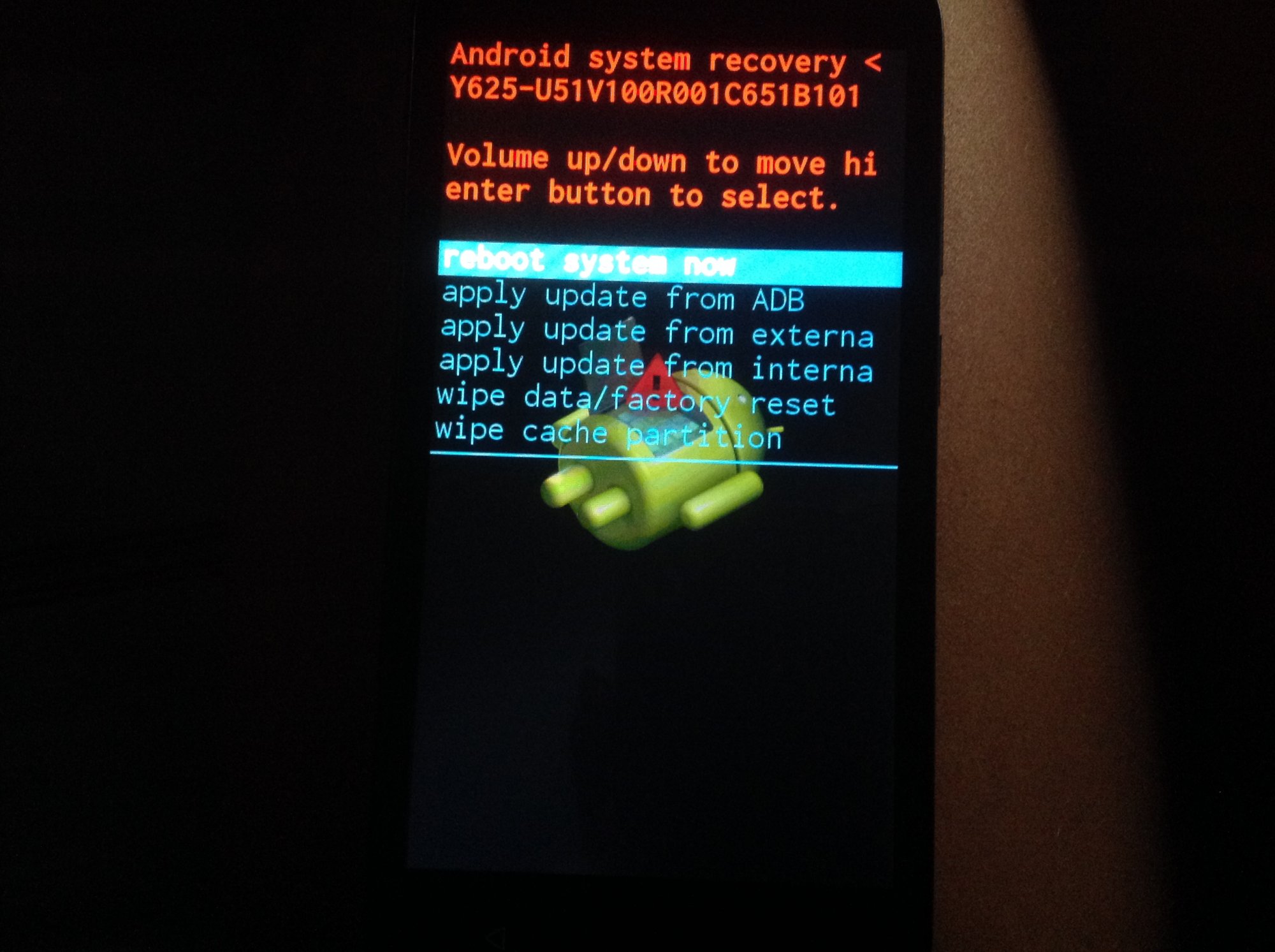

So, I have this same problem, when I turn my phone on, it shows that "encryption failed" message, and when I hit that button that shows, the phone just turns off and on again, and it shows the recovery mode. I already did the factory reset and rebooted, but it doesn't work anyway... :/ it shows again the encryption message.... I don't know what to do...

If u go to recovery wipe data and all cache and factory reset should take care of it what I had to do a couple times and might have to redownload file could b coruped
