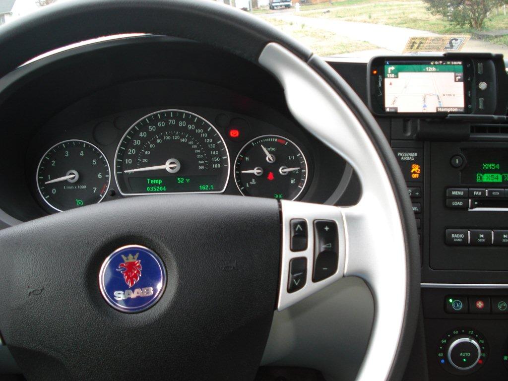

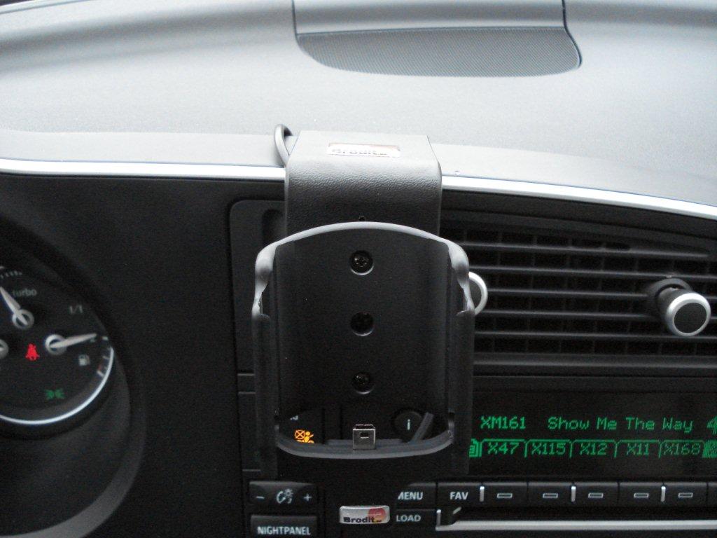

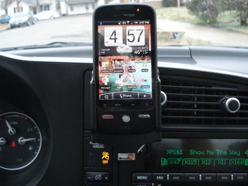

Daylight Photos of Proclip Install

Thats the cool thing with this mount. The clip that attaches to the vent can be changed out if you switch cars. The clip is 30 dollars and I can't tell you how solid this mount is. The tension is adjustable at the swivel. I know the mount is expensive. A buddy of mine has one in his BMW and looking at his sold me on it. When I saw the kit I was like my wife at the shoe store, I just had to have it!!!! :D

Ha ha, I actually got it for free because they forgot to put the magnet in mine. I ordered it with one because i originally had the moto droid. Anyways, they gave it to me for fee because of the mix up. Its an awesome setup though, easy to install too. I had to take off the dash and the panel behind the stereo to gain access to the place it needs too attach. But it attached with only one bolt that is completely hidden behind the plastic!

Ha! So funny on having to tear your dash apart for one screw but the install is very clean though. Looks nice. Now....I just need them to mess up my order so I can get a free swivel. :D

Paid exactly $118. Install I did myself took about 30 minutes or so. Used "Add A Circuit" to tap power from the fuse box. Very cool way to complete install. Allows you to add a device without splicing into the factory wiring harness. You just find something that is powered only when your car is running (Like most cigarette lighters). Insert Add A Circuit into fuse block and whatever fuse you removed you put into that first slot and the one with a wire runs to whatever you are providing power to. I bought my circuit at Autozone about 7 bucks I think. There are cheaper kits available. Look here: ProClip Mounting System

I do like this look of this install the best by far, especially that there is integrated direct power at the holster.
My question is this . . . what would be the best way to stream music from this configuration?
Currently, I drive a 2009 Mazda 6. In the center console, there's an audio input (headphone jack) as well as an extra cigarette-style outlet for charging. I currently use a Verizon car charger for both my Eris and Blackberry and I use the audio input for the Eris to stream music files, Pandora, DroidLive, and GrooveShark. Unfortunately, I do not have any Bluetooth capability.
Think the best way to do this would be to get an extra long headphone cord and try to run it under the dash, then underneath and into the center console?
I really like the look of the mount and would love to ditch the Magellan GPS I'm borrowing from my brother, but I want to make sure I keep my musical dominance available.
Any help or advice would be appreciated!

Peter Frampton?? Yikes, no wonder you need Pandora.
LOL I like classic rock and XM is really cool, I tend to change channels a bunch. If I would have taken that picture this afternoon it would have been on XM 115 (Disney Channel) with Miley Cyrus rocking the Saab :o. My daughter gets her channel on the way home from school on Tuesday's and Thursday's.

I looked at many different options when I installed mine. I removed the center vent and thought about running my hardwire for my phone mount kit through the vent. My Saab has a GM radio in it which means I'm stuck with the Aux plug on the bottom right face of the head unit. I'm looking at adding a plug on the back of the radio to allow me to plug into the head unit sight unseen. If I were you I would run your hardwire for power lead and Aux cable together. I was able to run my hardwire along the top edge of the Dash bezel and down to the center console, you can't see the cable in that position. You just have to take a look. I would recommend checking out a Mazda forum and search the forum for others that have successfuly installed a hardwire in the location that you are looking at. Most car forums are a wealth of knowledge, and the members are usually helpful.
