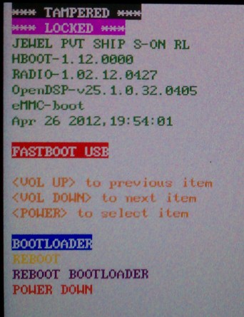

I went and S-OFF'd anyway, though, just because ;). But check this out:
attachment.php
Now you might be asking yourself, why would you want it to still say TAMPERED and LOCKED at the top? But wait - it says LOCKED, and not UNLOCKED, which I previously was. You'll also notice the LazyPanda watermark is gone. I used the old hex edit trick on the 1.13 HBOOT to overwrite that version (I also removed the red text that displays on the splash screen).
But what it didn't do was re-enable NAND security (S-ON). I hope a method for doing this surfaces at some point.

Great stuff, regaw.
attachment.php
I guess some of us are just OCD/paranoid about restoring a phone completely to stock when returning it. Now that I can do that, I feel extremely comfortable and confident with S-OFF :).
Thanks too for the modded HBOOT with the red splash text removed. I was able to remove it from my modded version as well, using yours as a basis (and Beyond Compare + Hex Editor Neo).
