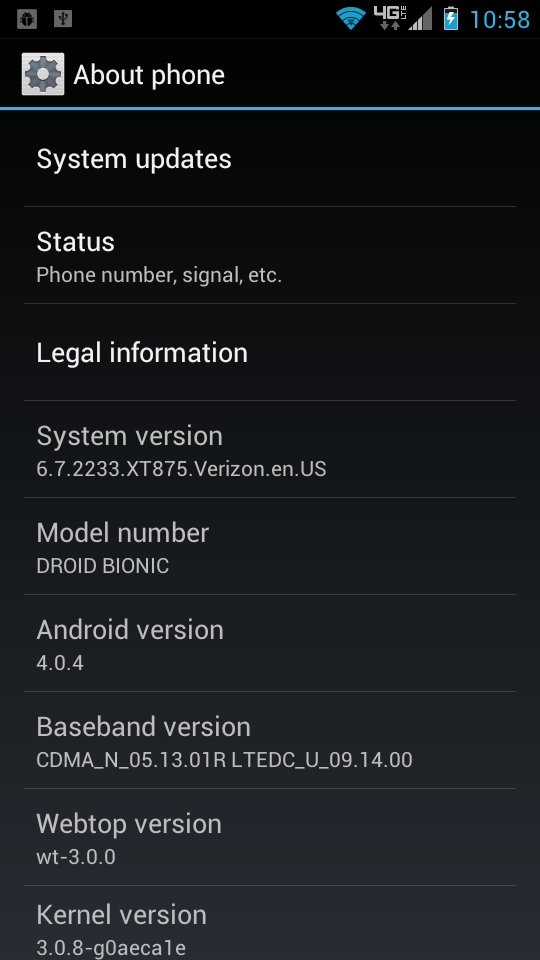

Here are the pics:
You posted two images for 6.7.2233.
Could you post 6.7.2231 at Systen version? This then includes System version through Build number.
Thanks.
... Thom

For the records (you'll thank me in the future) ...
If you are running 6.7.2231 please post a screenshot of About phone from System version through Build number.
Thank you.
... Thom
