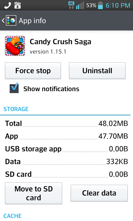

Optimus F3
Did you guys try to use the native move to sd from inside menu/setting/app first? It doesn't work for all apps but I did manage to move a few.
Where you finding this at? I knew where it was on Android ver. 2, but when I look in manage apps on the F3 there isn't even a button for it - greyed out or otherwise. :confused:
It's on my F3.
It's on my F3.
Thanks for the pic. I don't see that button on mine. So I'm guessing unlike Android 2, where it would show the button but greyed out if you couldn't use it, on Android 4 it must not show the button at all if the move isn't possible.
