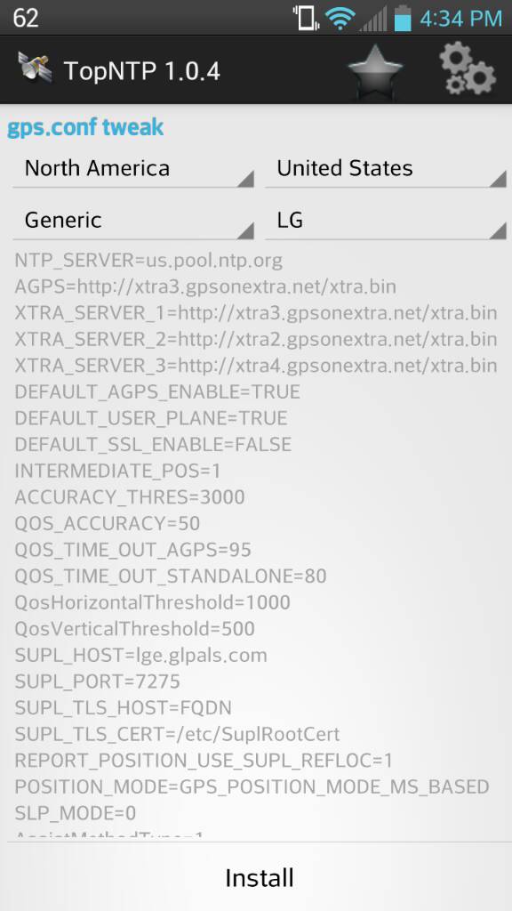

I think I managed to fix my GPS or at least it is improved drastically. I tried a whole bunch of different settings and GPS apps but none helped. Last night, I discovered an app called TopNTP. Besides selecting what pool of satellites to choose from it also has the option to change your GPS.conf file to different settings by manufacturer or carrier. It completely replaces whatever is in your GPS.conf with what you choose. I chose the US as my pool and LG for my GPS settings. Here's a pic
Yo, I think u hit the nail on the head with this app.
My Waze navi app is showing everything in my area.
Before it didn't show nobody but me!
Good find!:congrats:
It was working alright and then stopped. I think I messed something up from my tinkering around. I want to completely restore my phone to stock and then use this app again and I believe then that I'll get my GPS where I want it.
Hi MapleBacon, I was going to download TopNTP but is says it's for rooted phones. I have not rooted my phone. Must the phone be rooted for the app to work?
