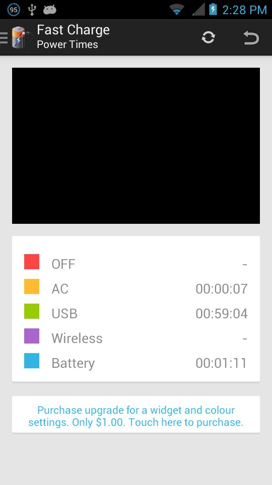

i cant tell a difference either with fast charge on and tbh my phone runs hotter and battery drains quicker. Probably going back to all stock tweaknation..i use wifi tether a lot and my phone temps were 95~100
