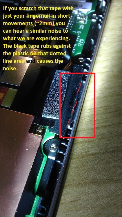

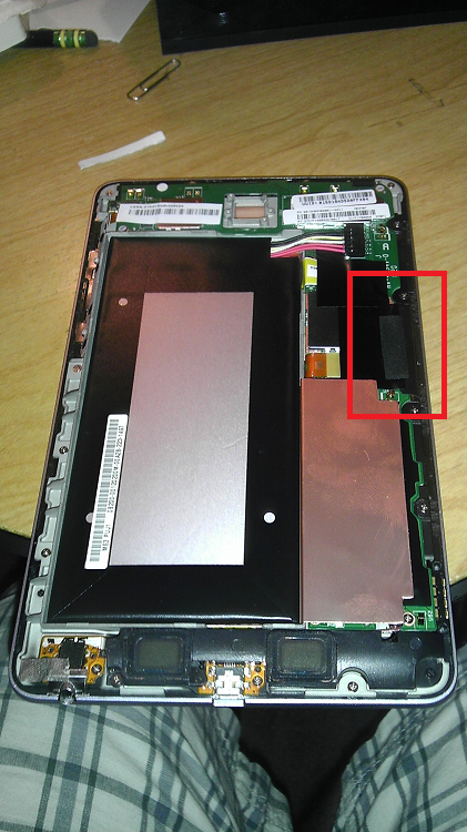

OK! So when I opened my new baby, I immediately squeezed the left side. And....Creak! :mad:
So I read threads and articles about tightening the screen screws or removing the foam. Obviously that has NOT WORKED. There were a few theories about the cause of the infamous left side creak.
-Lose screws
-That stupid piece of foam
-Bad glue application
I have concluded that the most likely culprit is here.
We need to put something in between the crevice where the plastic clip, and that black tape plastic meet. I used a heavy piece of paper about 1.5in long and 1/4in wide. And I just slid it in between the two points. The noise issue has been completely solved for me. As a note, my screen rise has been very little. Maybe a millimeter or so. PLEASE let me know if this solves the noise for you

Well I loosened all the screws and then redid them in a mirror pattern. Hard to describe, but sort of like how you tighten lugs onto a car wheel. Lightly tighten all and then torque the mirror opposite of each one. I don't think the screws can do much though. If you look step 20 on ifixit you can see that there is larger gap between screws where, not coincidentally, the lifting is showing up. So the problem is definitely in the original design. As for stripping the screws, you have to be really careful. Just used plenty of pressure when tightening

I know! The battery in this one is massive. The board is just a simple L shape
So last night I was closely examining the glass. I have concluded, almost without a doubt, the glass is rising because the surface that it was glued onto had a defect. Couple that with the heat in the back of a UPS truck and the screen lifts.
So last night (7/22) I had the idea to undo that process.
Basically what I did was apply firm pressure with the length of my hand on that left edge (Imagine a karate chop on the edge of the device). I had a theory that the warmth of my hand and the pressure would sort of re-set the glue and glass. I held my hand there for around 30 minutes. Then I made sure that my battery was very low (5%>) and turned off the tablet. I then plugged it in to charge. The reason I did this was because the tablet gets substantially warm when charging and off, which would soften the glue. I also made sure to put the spine of a heavy textbook on the left edge. Again, to try and set the glue with warmth and pressure. So as the tablet charged and stayed warm, the book would put enough pressure on to re-align the screen. After the tablet was charged I unplugged it and let it sit overnight and cool but still with the textbook on top. Finally, this morning I took off the book. The results:
My screen has stayed down the entire day and is approaching 12hrs of no lifting :D I can't say if it will stay like this, but it's nice not having the problem. I can only hope that the glue is really set now.
