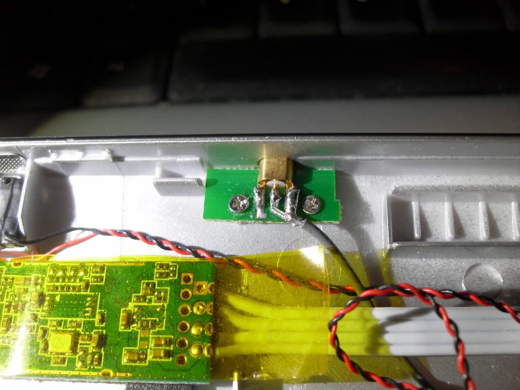

Hi, I got a new flytouch 3 (Android 2.3)
Problem: build in microphone is very bad. You opened the case, is this microphone an extra device?
guess condenser mic... is there a change to replace it?
Can't comment on a 'new' flytouch 3, but the 'old' flytouch 3 has an electret mic soldered on the pcb... the silver circle in the middle of this picture..
So yes.. it can be replaced.. but would a replacement be any better?
So, assuming the pcb hasn't changed, yes.. it can be replaced.. but would a replacement be any better?

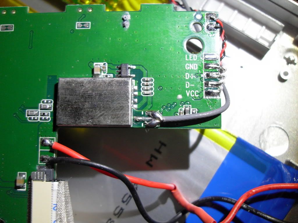

Hi everyone, I'm new to the forum. I too have problems with GPS. Someone can put photos from the GPS receiver to see if the welds are defective. thanks
The gps receiver is embedded on the main system board but I think you mean the feeder wiring connections...
Here is the socket end
and here is the pcb end
You are looking for solder bridging the contacts. It should look like these pictures if it is good.
