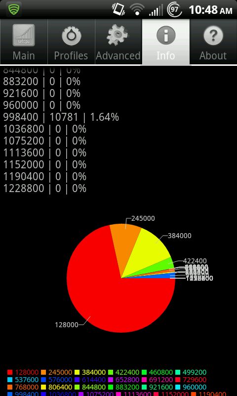

I know thats the way it should be, but I've posted screenies before of my time spent in each state with a screen off profile and without one and I have significantly more time at my max without it than I do when I have my screen off profile (hardly any time at max)
From a previous thread with a screen off profile:
Example:
My CPU levels by % (taken yesterday)
Taken today without a screen off profile:
Roughly same amount of total time on each.
So I'll keep my screen off profile.
