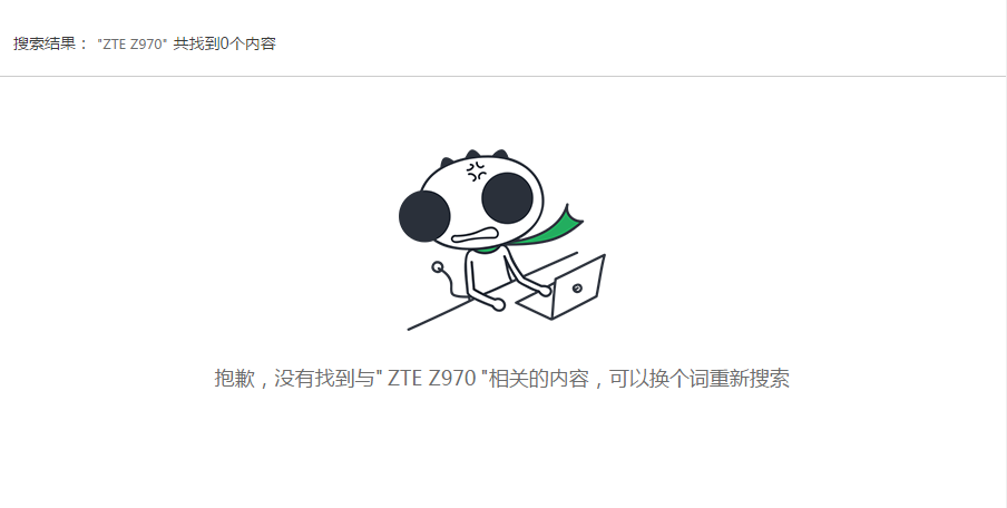

well i did a simple search of "ZTE Z970" on the website you provided and nothing comes up, so im clueless as to what i can do to help resolve the situation with my zmax, cant boot into recovery, cant boot into anything...
nothing comes up.
