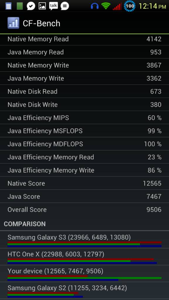

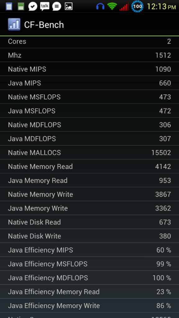

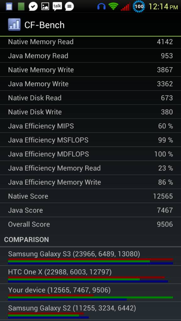

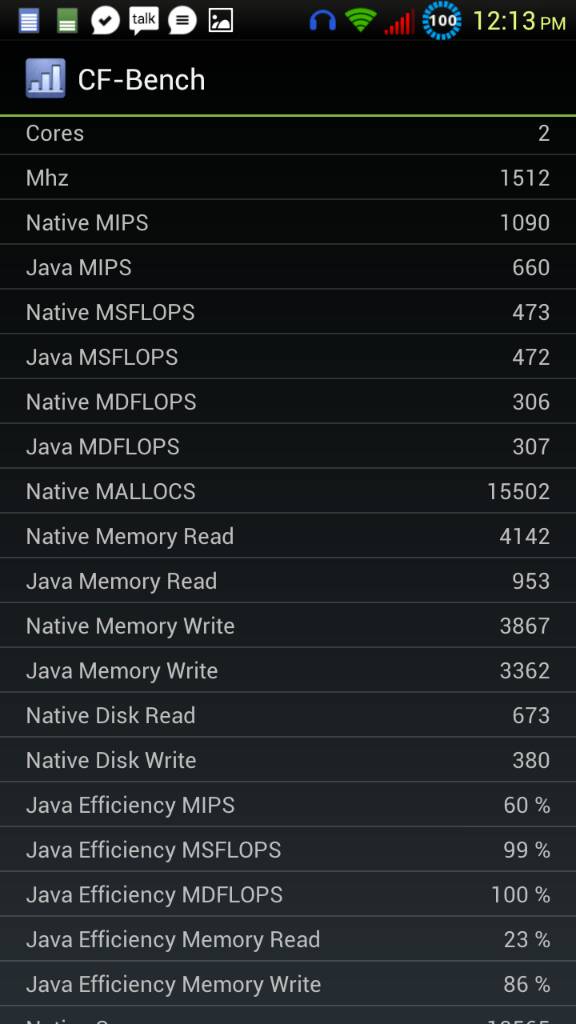

If you want to see for yourself, check out "CF-Bench"
https://play.google.com/store/apps/details?id=eu.chainfire.cfbench
But be sure to read the app description, this is not your typical benchmark.
While not intended to rank phones, really, this is the only benchmark that seems to match my experience comparing phones when I consider just the Java predictions, matching the green bars in the second screen shot.
Notice that there aren't Java tests for everything that there's a native test for - some things just are not done by an app, they're done by the underlying software services - and those are ALL native code.
