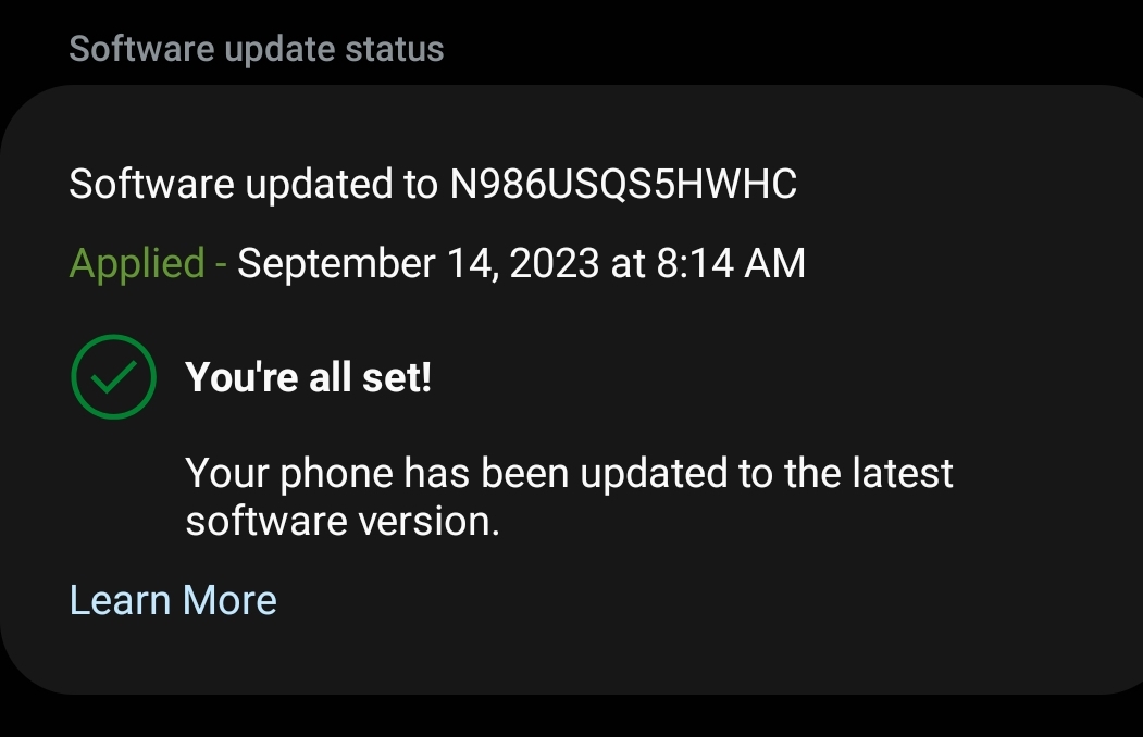

My Verizon Galaxy Note 20 Ultra did an OS update on Sept 10th, 2023, and again on Sept 14th, 2023.
After the first update, I noticed that my Google Assistant stopped working, but I didn't have a chance to troubleshoot it until after the 2nd update (which didn't fix the issue).

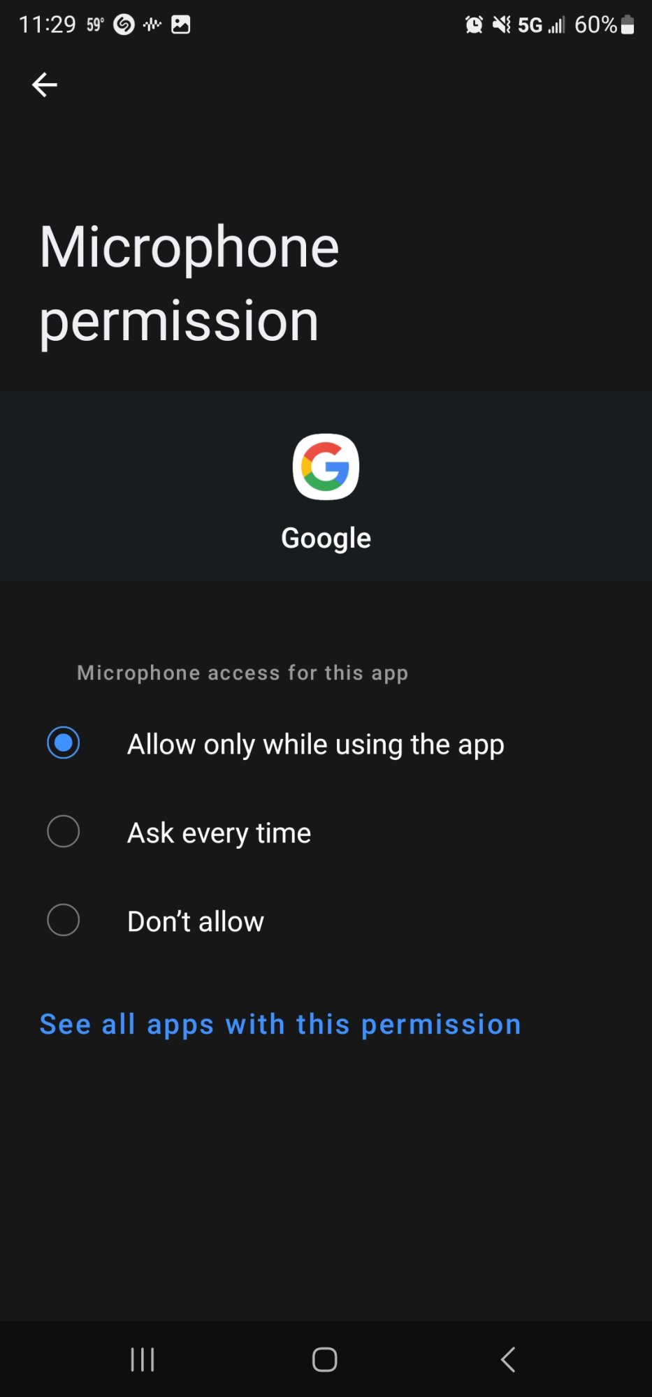

I use a widget on my home screen to tap the mic and ask questions (doesn't work), I use Google messages as my messaging app and the speech to text doesn't work, I go through my apps into the Google app to ask a question (mic doesn't work), and I try to go through the retrain my Google Assistant and it doesn't recognize my voice.
None of these things (that worked prior to the OS upgrade 9/10/23) work now in the regular OS, but if I run the phone in SAFE MODE, they work fine.
I've deleted unnecessary apps (including 2 anti-virus apps I didn't know I had and don't have a subscription for), I've checked all my app permissions (I can only set the microphone to "allow only while using the app"), I've even checked other forums but cannot find out what's going on and cannot figure out what's killed it.

It HAS to be a permission somewhere....
In the picture you posted, upper right hand corner is the speaker icon saying your sound is turned off? If yes could that cause your mic problem since it works with your do not disturb turned on?
The speaker is saying my ringer is set to vibrate not ring, but I just tried it with my ringer ON and it still didn't work.
Yes, it works when DND is on! I'm baffled....
