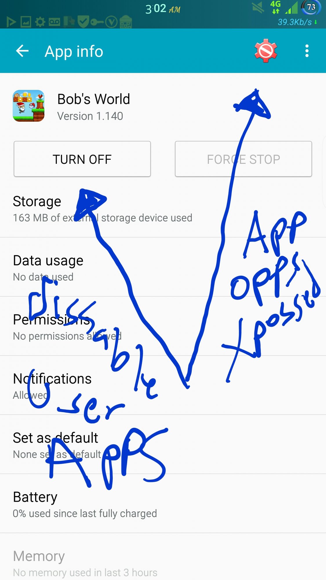

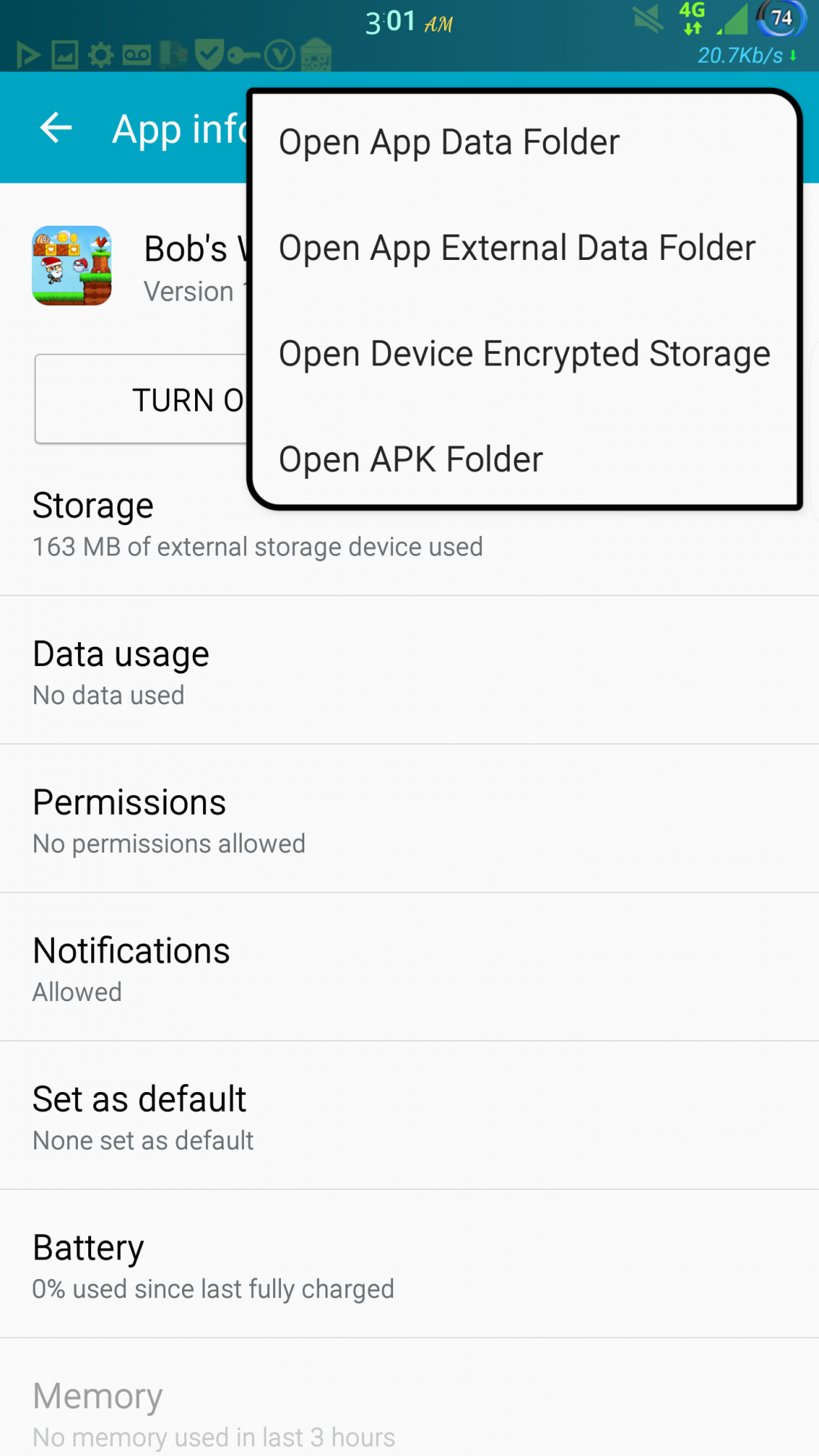

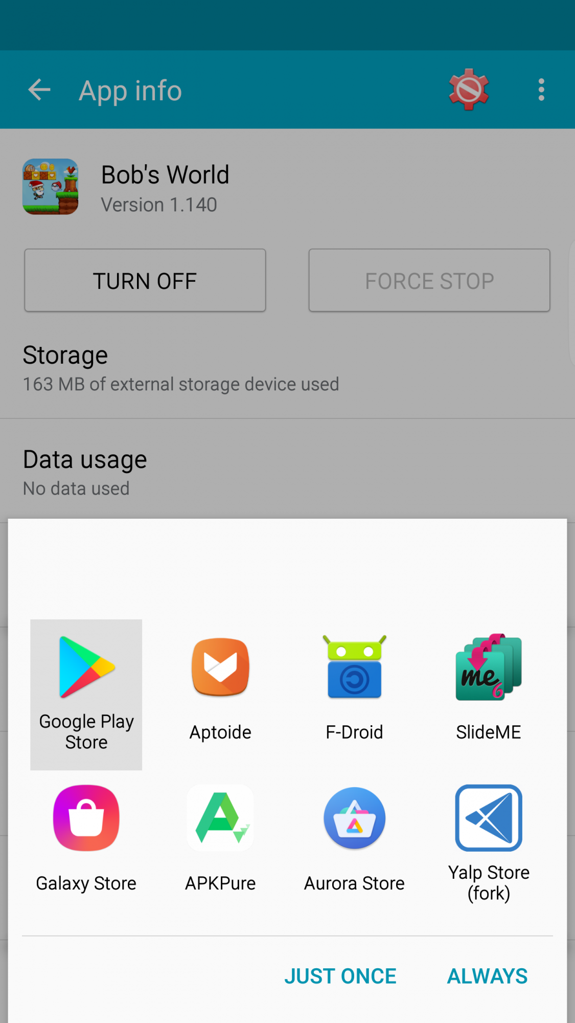

Long press icon in the setting and choose your app store
Tap the icon to lauch app directly from settings
Disabled user apps

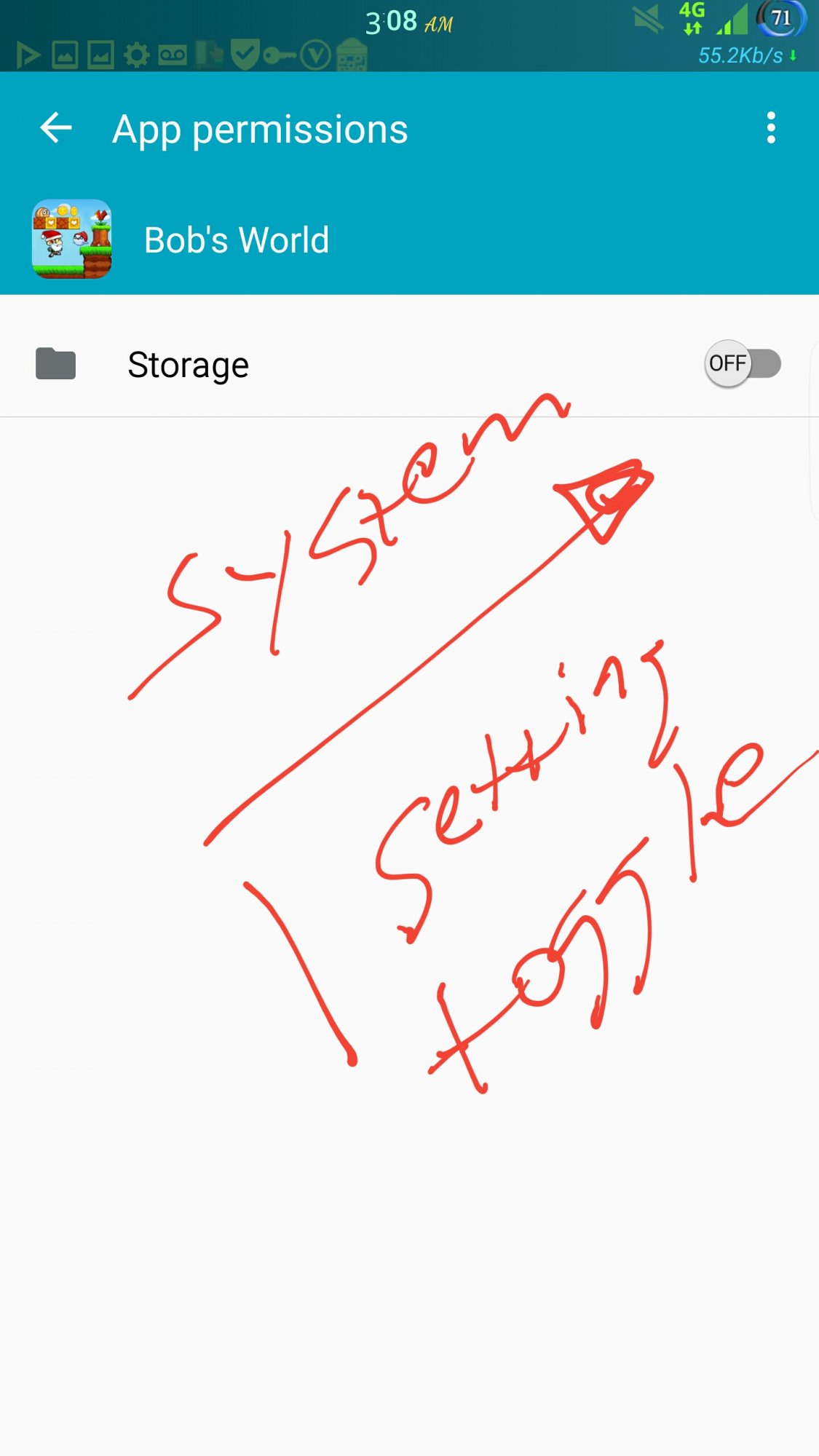

Additional permission settings more toggles than stovk
3 dot menue streat to giles and foulders
ALL OF THIS COME FROM XPOSED MODELS AND THE POWET OF ROOT

So that app BOB is your xposed app?

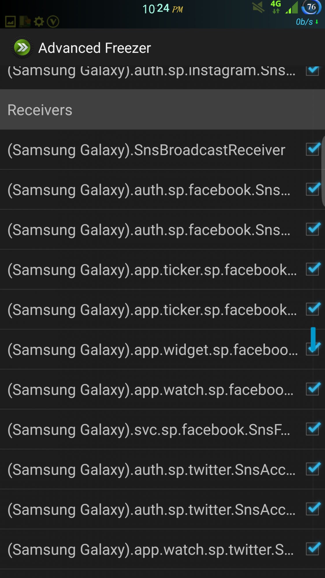

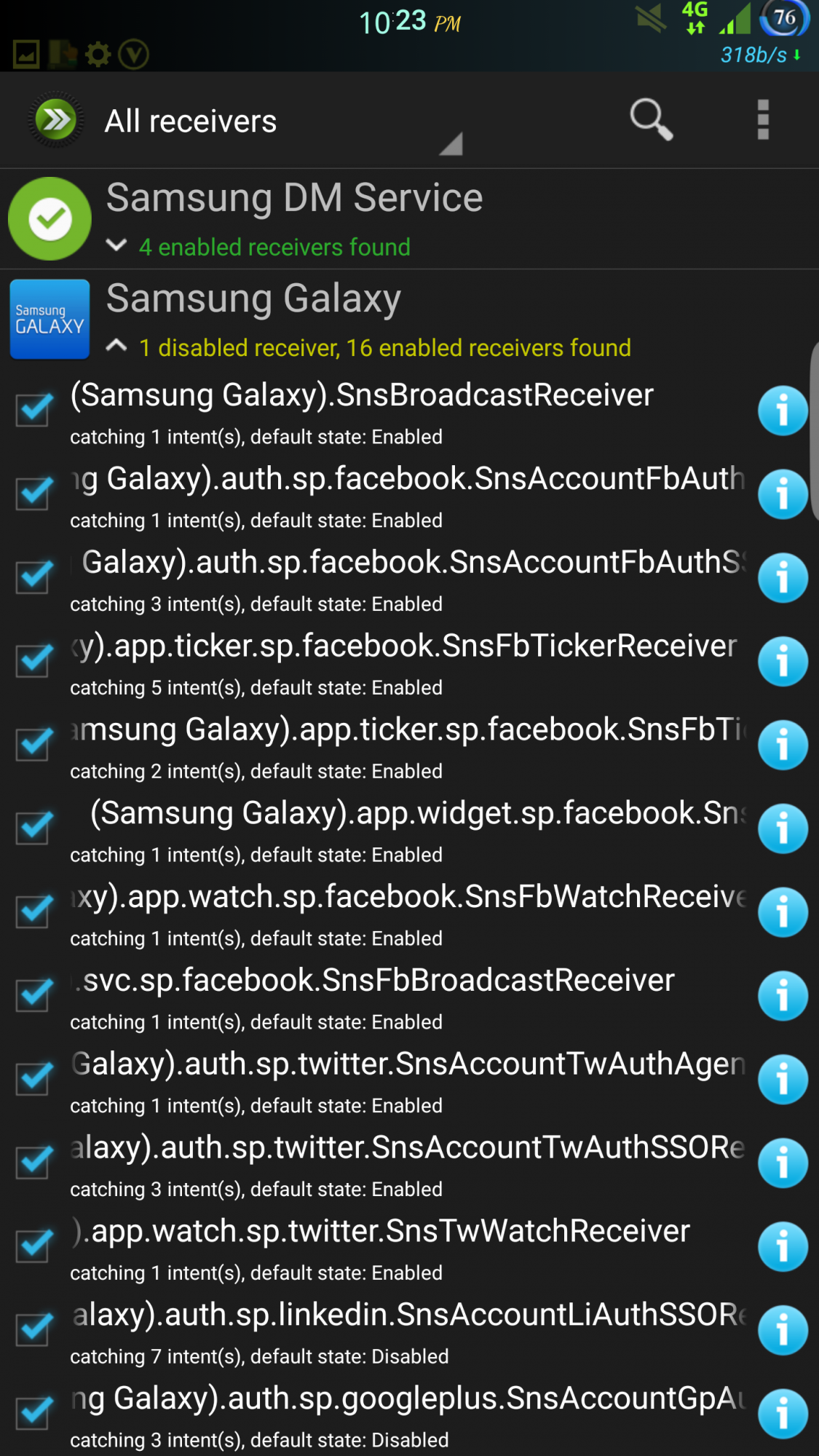

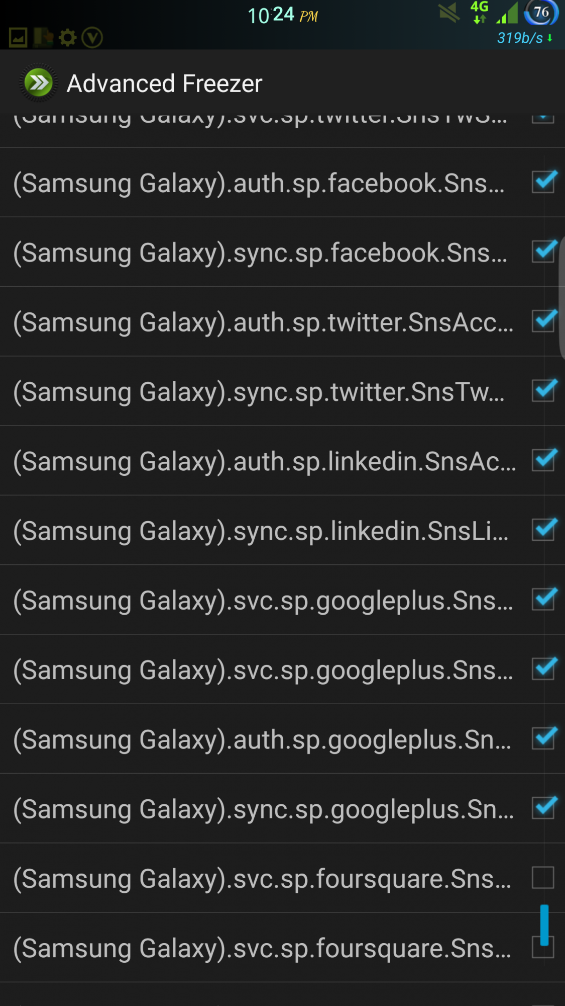

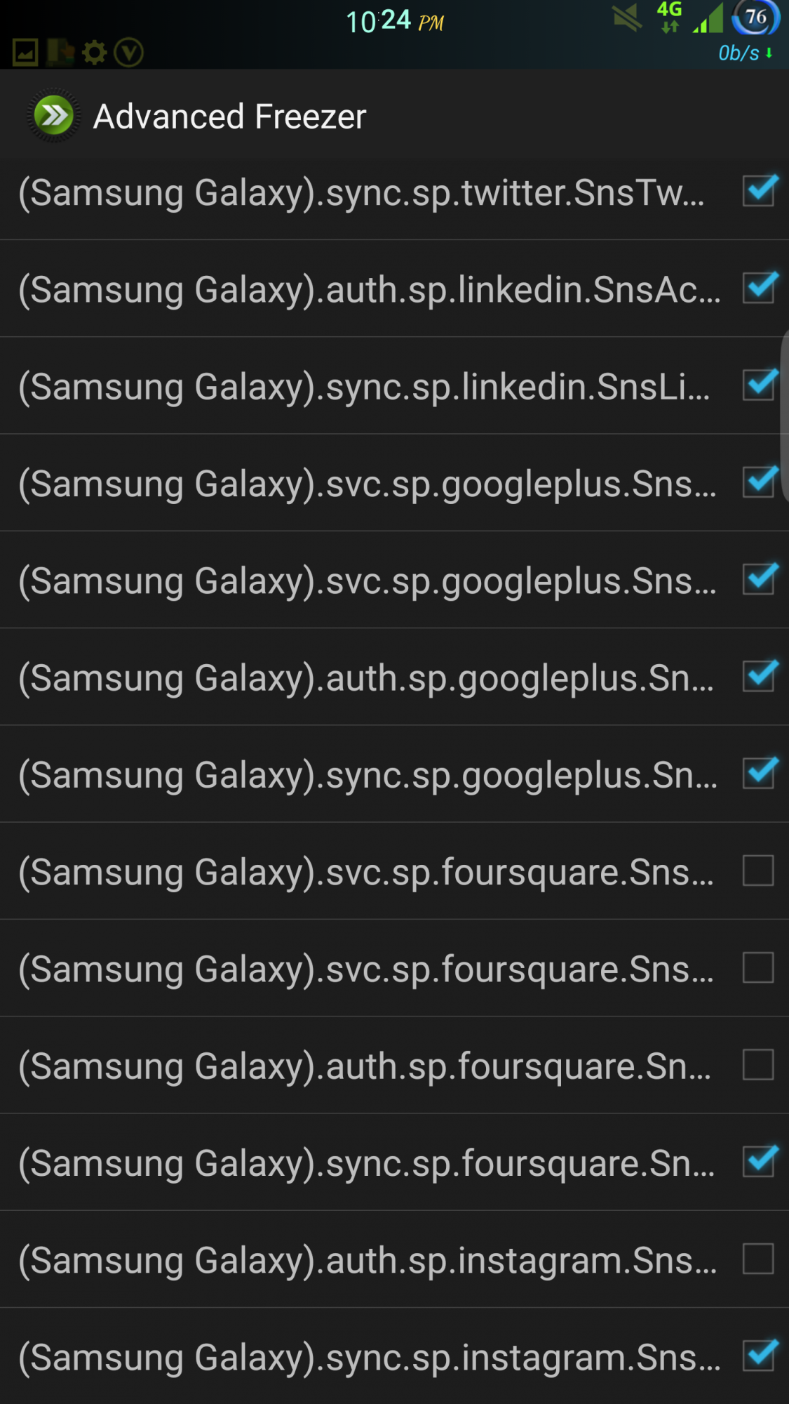

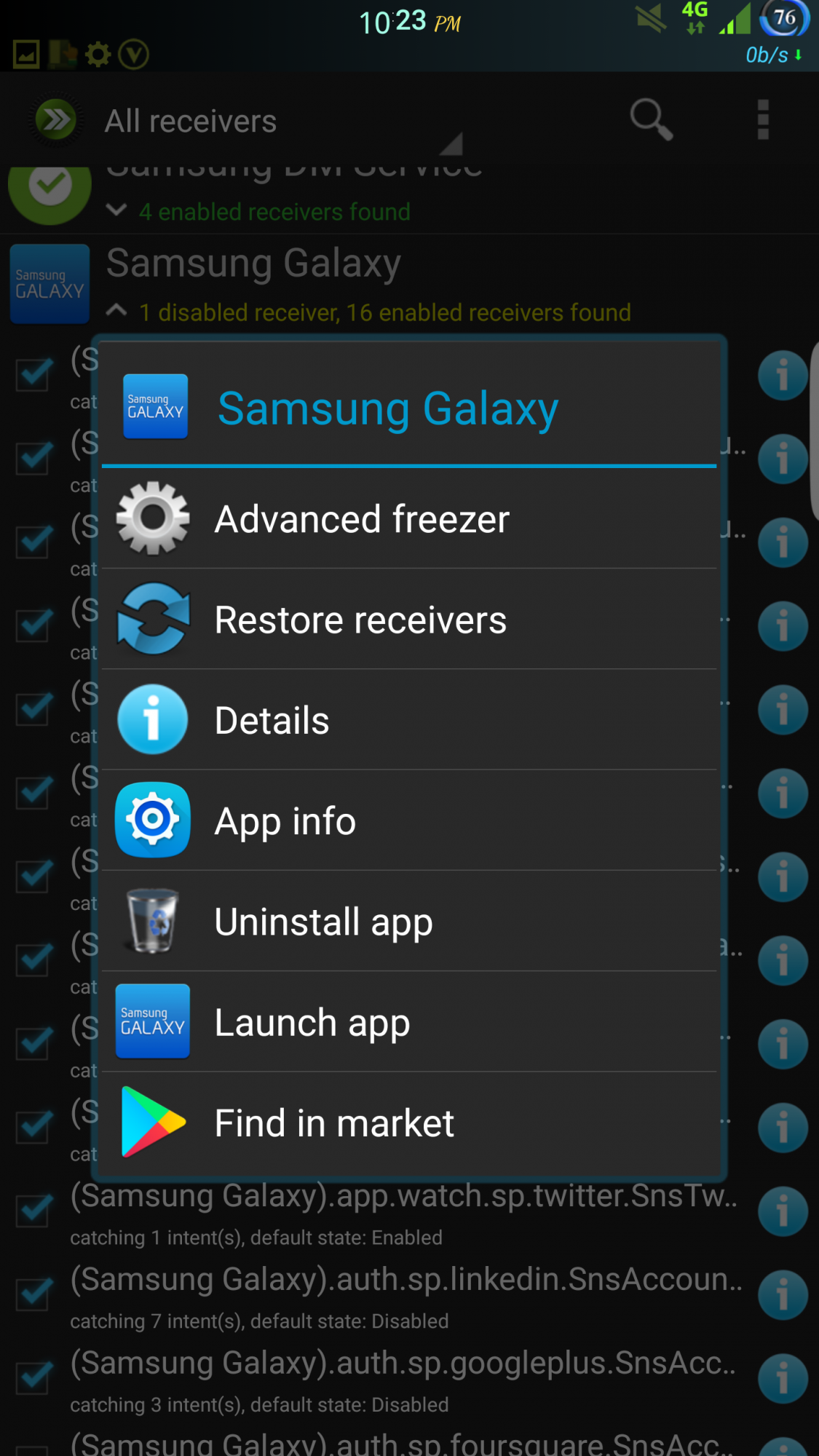

I just discovered Itson is only on Sprint phones. One of the first system app I removed was Samsung Gaxaxy app or Galaxy. Not to be confused with Samsung Galaxy store. I still have the Galaxy store, I recommend keeping the it.
Samsung Galaxy is a pre-installed system app that is used for data mining and harvesting user information. The pics show the app receivers.

Hey there!, well I removed it..ALL OF IT..the five or six components of it..and so far haven't gotten any problems or "force to close"..the screen shots are working..not funny windows..in fact..since I removed it..the battery is been barely at 91° while in heavy use and about 83° at not use (remember I was complaining about the battery been so high?)..so that's a good thing considering all what's been told by the community about knox..like something not to mess with..well there it is

Sorry to be stubborn and sound repetitive..but tell me again..and exactly with what method was that you were able to achieve the "once or always" dialog???..
I'm asking because that's mostly what I want..and if I can avoid the custom rom and rest of it..just by a little simple method even though I already downloaded every thing I need and wasted all those gigs off of data..i'd rather do that, feel me?

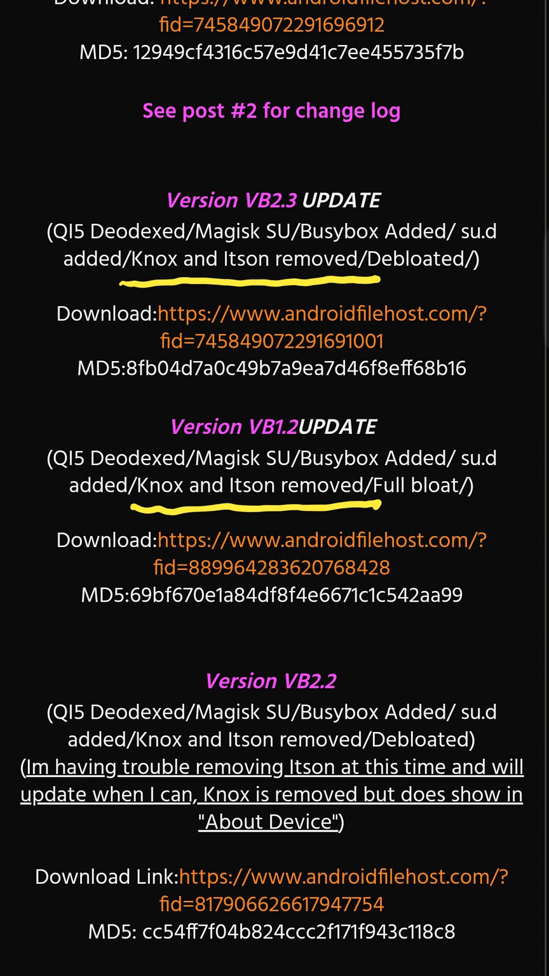

https://www.google.com/amp/s/forum....910t3uvs3eqe2-stock-rooted-odex-t3635629/amp/
This rom may be of interest. Says removing knox cause problems so knox is not removed. Thats a first :)

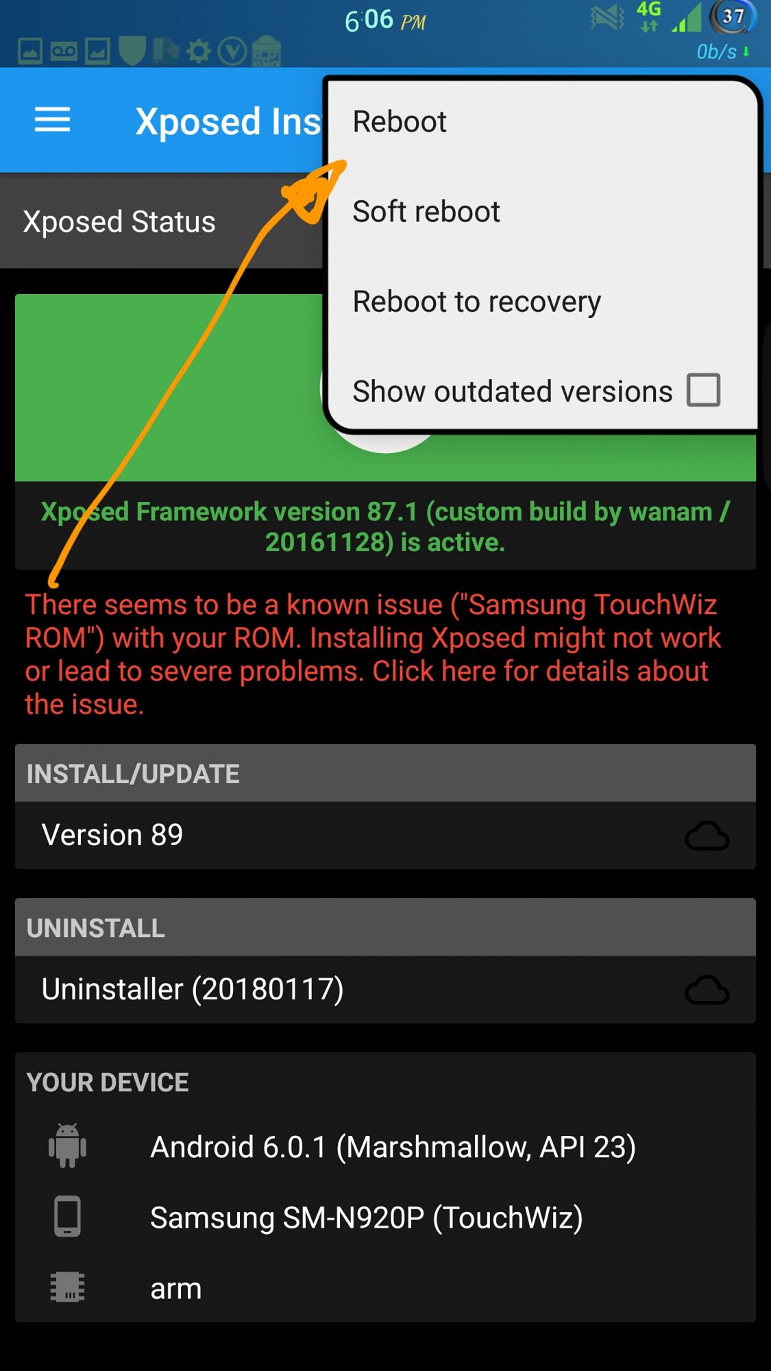

There is a link inthis thread to download the Xposed (post 3) but it is a bit confusing. I can provide you with another link that works on my N4 if youd like. Make sure to download both the Xposed famework .zip and the Xposed framework uninstaller .zip. If you bootloop just fash the unistaller .zip.
This is the Xposed installer apk in order to grant root top setting tap reboot and grant permision afterwards flash xposed framwork.
