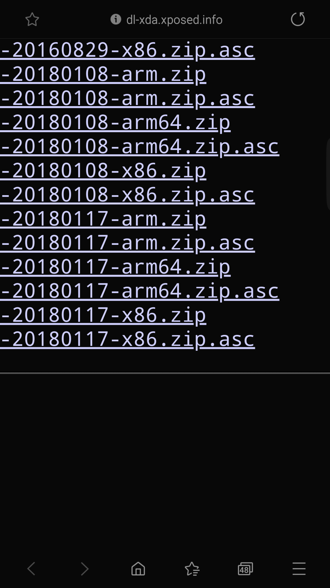

Galaxy Note4
http://dl-xda.xposed.info/framework/uninstaller/
20180117-arm.zip
Go to the site and download its 6th from the bottom. In the event of bootloop caused by Xposed or Modules, then you can flash the unistaller.zip wipe chache/dalvik and chach from advanced setting TWRP and reboot.
