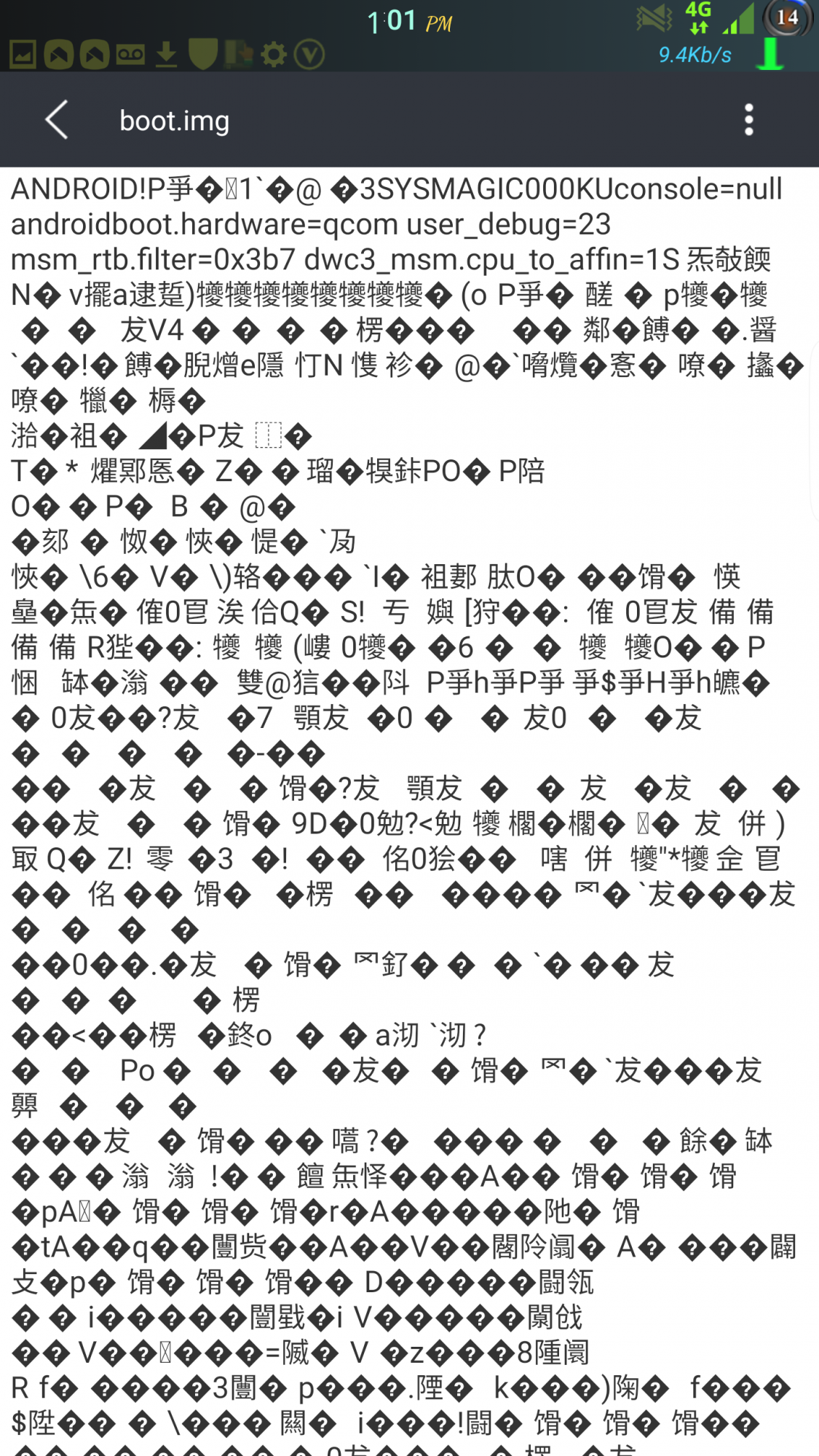

At present, I would like to port parts or 2 different custom kernels for my n910p. In my situation , the first is BeastMod permissive kernel developed by Freeza. Its overclocked and has lots of governors to choose from. Even without tweaking it pretty fast. Since It was developed for a lower aboot/modem 6.0.1MM network data leave me at 3g max. The other petmissive kernel was developed with my aboot/modem and network data is 4g/LTE but overall petformace is good, a definite improvement of stock but not as snappy as the BeastMod kernel. Im just starting trying to get familiar with the WTF am I supposed to do. LoL. I may be a bit over my head and Im definitely in unfamiliar territory. All I need to do is find the file or foulder (3g/LTE ) fron N7 kernel port it to bestmod kernel. Well , Im hopeing its that easy. Time will tell.
This is what the BeastMod kernel Boot.img looks like OMG!! Dam
Im going to take a big risk and port a custom kernal and even maybe delete some files (mpdecision), supersu and busybox from the kernel .zip file.
I"v never ported or modified custome kernal because I never felt the I needed to.
I cant find information pertinent to porting 2 custom kernel or deleting specific file/folders. Im hoping it somewhat similar to how I port the system with root file manager.
The only porting that I do fined are for different purpose. I had thought of just applying one port with mo deleting other file bur just repace one with the other but Im going to do the rest anyway so off the deep end I go. Im not just taking a blind jump but a big calculated risk. It just seem somewhat logical in my view. (kind of).

No, porting kernel definitely is not what I am suggesting you do. Its something Im going to do. Basically, Im pulling and replacing files/folders from one custom kernal to another custom kernal. Then I will delet s few files, save to external sd, boot into recovery and flash the MrJavi custom ported kernel. I may endio in a hard bricked N4.
One kernel is super speedy, quick, quick, quick fast but stuck on 3g data
The one I have now has 4g/LTE and is quick, responsive, and much much better than stock but not nearly as fast as the other.
Im going to combine parts that I think are related to 4g/LTE network connectivity. (files/folders) .
With the fast jernel Ill delete the related files/folders and repace them with the 4g/LTE file/foulders. Then fkash the kernel I modified and hope I dont hard brick and also get 4gLte working with a fast kernel.

I wish I would have know this a ling tine ago. Im in Awwwww. It felt like my old N4 and data too , I can put inyo word how happy and amazed. I can believe mo one post this on XDA, at least non that I could find. Im missing One thing Root, I need to flash SuperSu . BRB ;)
