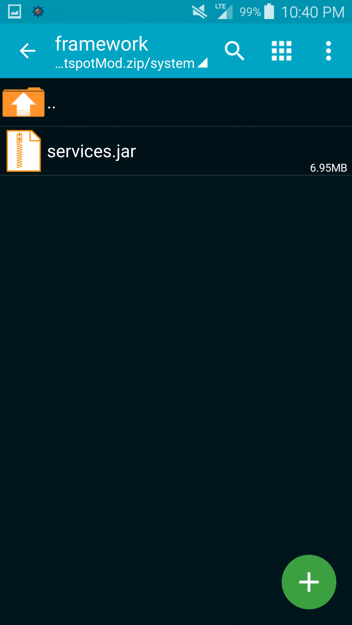

MODS ADD-ON Zip:
The Mods-V2.zip includes the following mods
1.Advanced Power Menu
2.Remove Permanet Notifications
3.Once/Always Default App Selection
Hot Spot Mod include
Number 3 is what I find most concerning in regards to compatibility with your device.
I downloaded a separate HotSpot .zip from another developer and compareed it with the Mods-V2-.zip
The HotSpot.zip
The Mods-V2.zip
The service.jar is among other things will unlock the Sprint HotSpot for the n910p. Im not that familiar with service.jars but Im almost positive that is carrier specific.
The Mods-V2-.zip also has the service.jar and 100% not compatible with your device.
