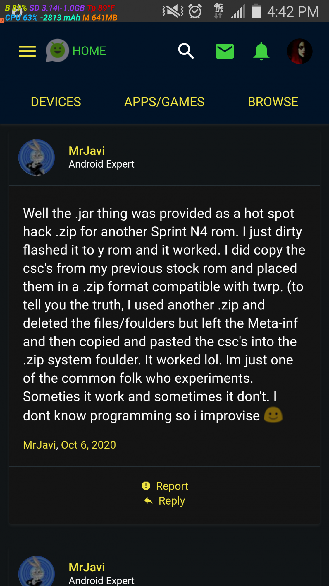

Let's get into that procedure, Javi!!, nothing would make me more happy is to fix that...
The Hot Spot setting was nissing from my custom rom and I was able to get it back by copying the csc's of my rooted stock rom. I placed them in a .zip and flashing it from custom recovery. As you can see, I got the hot spot setting to appear on my custom rom.

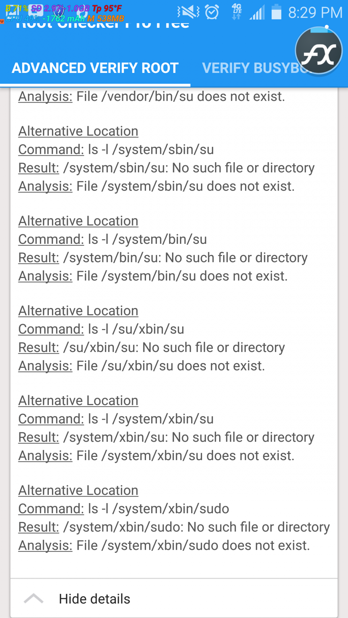

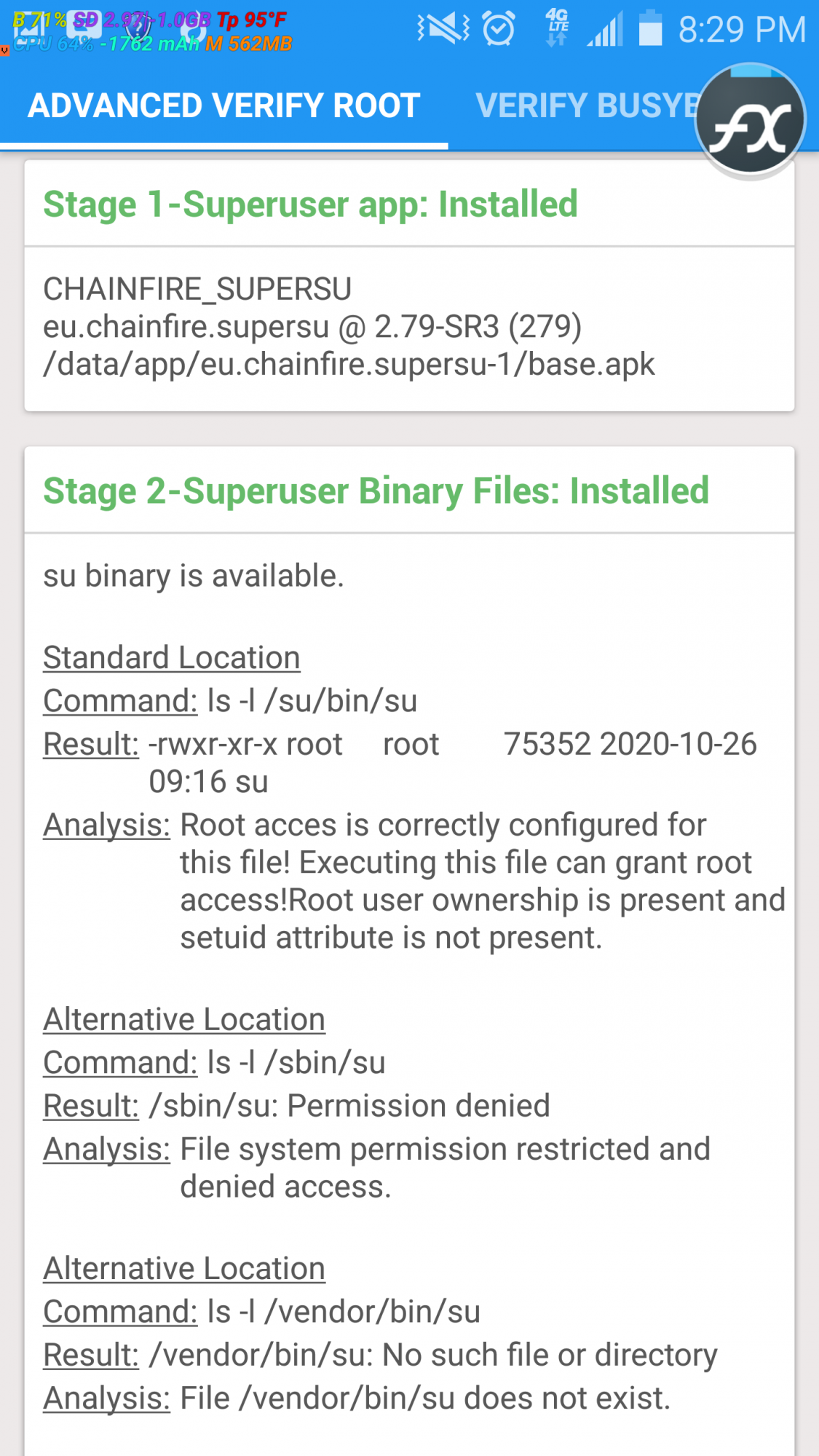

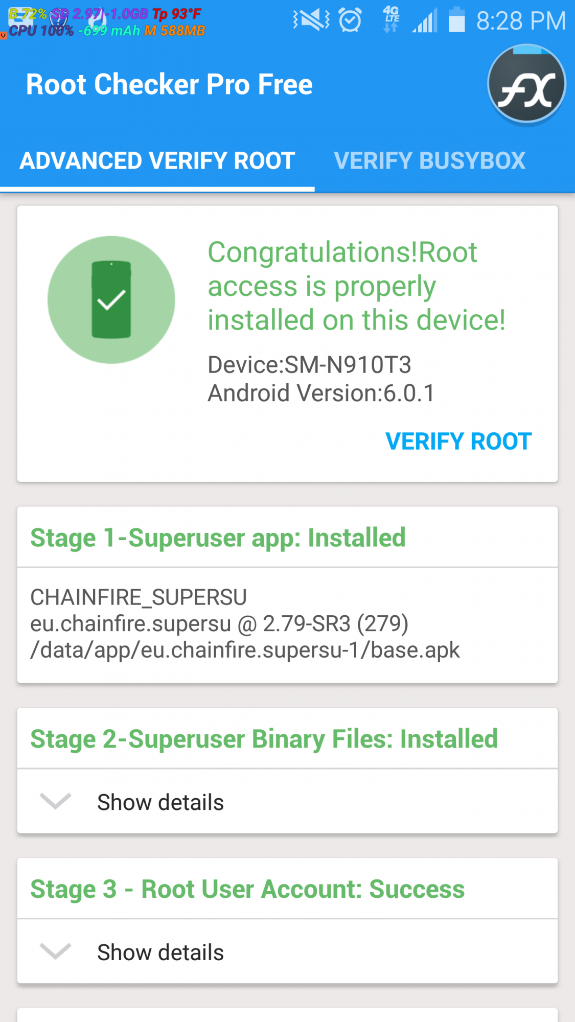

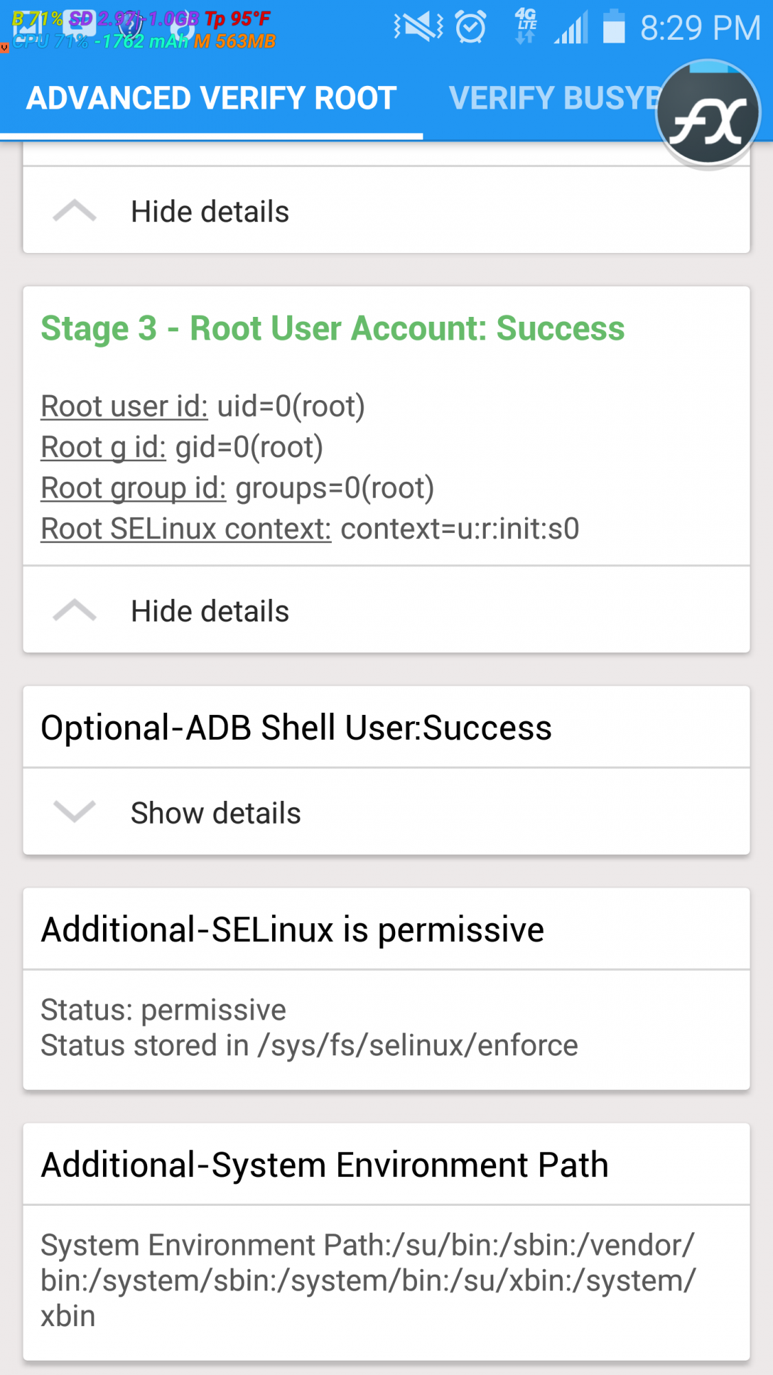

Javi, this is what the root checker says as of today...
It seems like multiple locations, right?
Great observation my friend, In fact thoughts are multiple possible root location. The end result is root success.

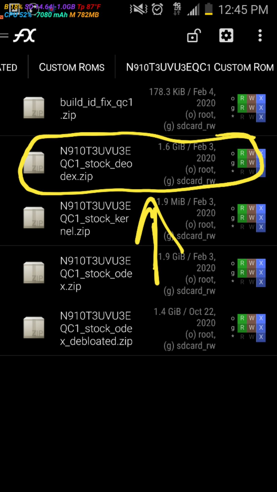

If you installed the deodexed rom in the link below then it doesn't have Magisk as the root method.
https://forum.xda-developers.com/no...-qi2-stock-rooted-odex-deodex-note-4-t3693711
Try it for a while, check you wifi, bluetooth and data connection. Does the rom feel stable? Aldo if you miss certain features of your old rom you may be able to port some of them them to your current rom.
This is an example of an N7 rom for the n910p.
Using ZArchiver app to view the roms.
The Apocalypse has Magisk
Just delete the Magisk ftom a rom and then flash it and after that flash correct SuperSu (chainfire) .zip.
Actually it feels very stable..muuuuuuuch more than the previous deodex I tried for a week..in fact I have my doubts it was a deodex(no where inside the about device says "deodex"..
I think I'm going to keep this one..

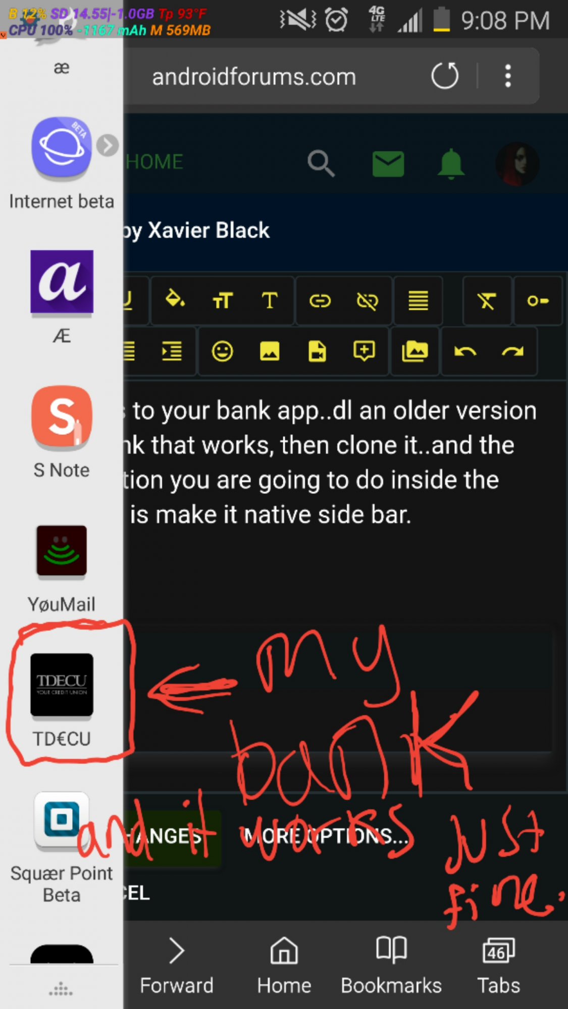

Another thing I've been ticking and wanted to share with you is I think I've heard you saying more than twice that your bank app wouldn't work on your fabulous Note4 because if the root, modified, xposed and so on status..well I made my bank work on mine..I will help you adjust that issue if you want me too.

In regards to your bank app..dl an older version of your bank that works, then clone it..and the only variation you are going to do inside the clone app is make it native side bar.
