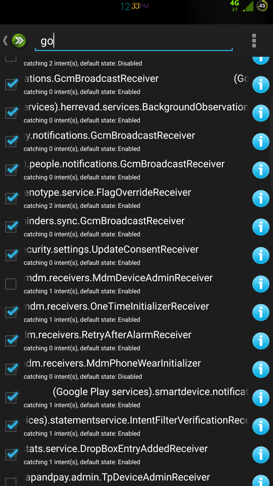

Can you uncheck them, reboot and confirm if they re-enable themselves automatically?
There is no spp on my device called "Find my device" so that leaves out disabling and uninstalling. I hit pay dirt non the less :)

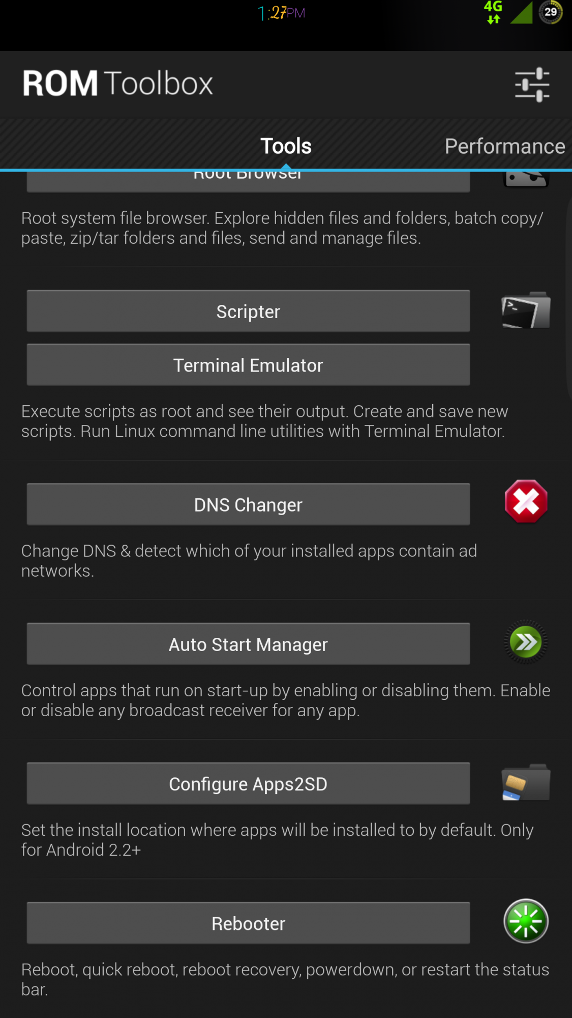

I did this woth Rom Toolbox pro Version 6.0.6.5 in "Auto Start Manager" (recievers).
To remove the "Find My Device" Administrator I disable it from Google Play Services in the midle of the screen shot below. "MdmDeviceAdministratorReciever"

Thanks to you, my very good friend and brother @Xavier Black . I accomplished a long time goal long forgotten. :) It began when I turned of device administrators. I noticed after I rebooted the enable themselfs automatically. One thing I've always hated about Google is its deceptive practices. Add a toggle to turn off Google davice administrators and knowing 99.99999% of the people will havr no idea it enable after start up and even if you do whos going to go to settings evry reboot to turn it off. Its social psychology and they know it all to well. Heres what I mean.
Yes I've unchecked it a million times..and look for it to delete its as..no where to be found..how do I delete it???

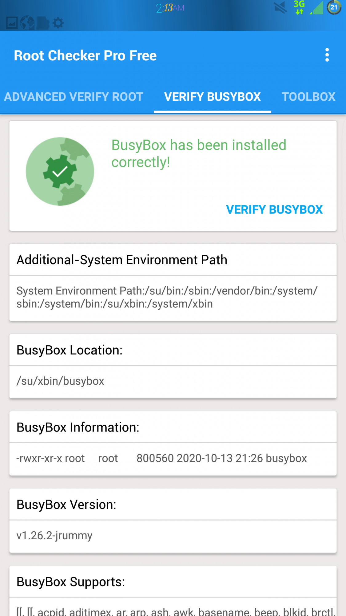

Hey brother seems to have super su and not magisk systemless..also apparently also has busy box..didn't know.

Seems like there's two different locations for the busy box..
ill look at the rom you installed from XDA. I will use the build number to determine which one it is. Did you install root checker pro free? if so did it display busybox applets in two locations? If so will need to correct that as well. :)

Sorry I wasn't reading you well..so you did it with the Rom Toolbox?

Let me rechapter..where or what option inside the Rom Toolbox you go to to get that menu of the targeting app?

Yes bro, it did in two different locations..found one with my file manager..the other one couldn't find it
I use BusyBox Pro by Jrummy
Now look at Root checker pro free on mine notice the location su/zbin/busybox and at the top "busybox has been installed correctly"
Scroll down on yours and you'll see a second busybox location. Thats the one that needs to be deleted using BusyBox pro by Jrunmy.
Where it says su/xbin on the right hand side tap the little triangular icon
Now tap the second busybox location that you saw in Root Chwcker Pro.
At the bottom tap uninstall. :)
