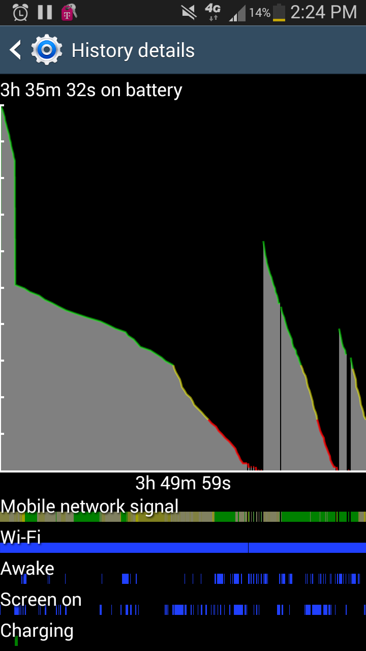

Hi there everyone, i have an extremely weird galaxy s3 problem. My phone immediately drops from 100% (it says full charged) to around 52% when i unplug it from the charger. Second, the phone can never charge more than 50% when i charge it turned off. The phone dies rather quickly (around 1-2 hours from the point of 50%). What's weird about this problem is that with enough reboots to my phone (2-3 reboots), the battery immediately goes from 0% back up to 50-60ish% . I can do this at the least, 2-3 times, although i haven't tried how long it would take for my phone to really fully die out. I initially had this problem with my original battery that came with the phone but for a while, i thought it was a battery problem, therefore, i bought 2 anker batteries in which the problem still exists for each. Second, i've even bought another charger yet to no avail, the problem exists. The very last thing i did was factory resetting my phone and it was working like a new phone with no problems on the first day but right after the first day, the problem came back.
Here is a picture of what i'm talking about. Here as you can see, my phone starts off at 100% and the second i unplug the charger, it drops down to around 50-60%. On the battery graph itself, you can see the steep drop in battery level for no apparent reason. from 50-60%ish till 0, it dies the first time. Second, you can see that it raises back up to green again when i reboot the phone. Once again, it goes down to 0% again and dies the second time at the red level indicator. Then again, it goes back up to green and when i accidently restarted my phone, it goes back down to red (the little dot near the end of the graph) and lastly, i reboot again and it is once again, back to green. It's obvious to say, with each reboot, the graph gets steeper and steeper so i mean the battery is dying even faster. What's the problem? I hope i provided enough information, i really hope you guys can help me. This is a refurbished phone tmobile sent me last march/april since my first gs3 had some headphone issues and they sent me a replacement through warranty/insurance

Have you tried a factory reset? (last resort)
I've seen the exact same issue caused by a firmware update that a factory reset fixed (as I'm sure you know, a reset wipes all user data)
Scrap that lol. I'd only scanned your post and just read back that you'd done a reset already sorry.
I don't know what else to suggest other than testing your battery in safe mode to see if it's a user app causing the issue or reflashing the firmware
If it's doing the same thing with a new battery, charger, new cable, and factory reset then their is probably something wrong with the charging circuit in the phone. You'll have to send it off for repair/replacement.
Another thing you can try is to charge your new battery with a wall charger (Anker has some inexpensive ones) and see how the fully charged battery acts in the phone. If the phone works OK then you know the problem is in the charging circuit.
