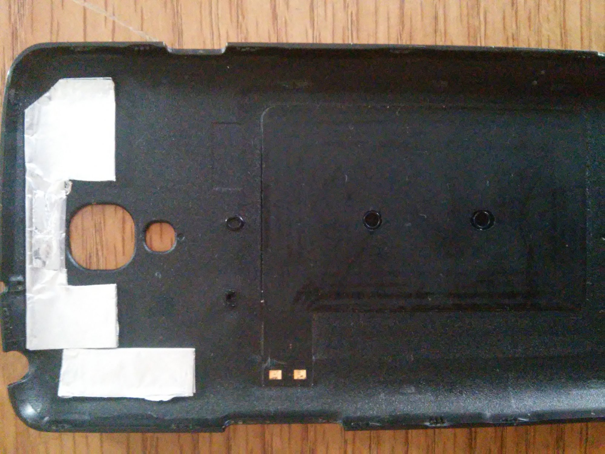

After trying everything here, and every GPS "fix" app I could find, today I tried the old fix for the Samsung S3 - turn it off, open the case and remove the battery, etc. Use a tiny tiny phillips screwdriver to tighten every little screw. Most were pretty tight already, none turned more than about 1/8 of the way. Put it back together and I've actually had a reasonably strong signal indoors throughout the day, and did a quick run outside that for once seemed to track correctly. I'll have time for a longer test tomorrow, but I thought I'd throw this out there if anyone else is still having intermittent trouble with theirs, maybe it's something to try.
Praise God; it works.
I've been in the same situation for a long time and have been checking this thread periodically over the past few months to see if there were any new gps.conf fixes I could try.
Then I saw your post and gave it a shot. It actually seems to be working for me! I tightened all the screws (most were already as tight as could be) and put my phone back together. This was 3 days ago, and I've been using Google Maps to navigate on my commute since then with no issue.
Thank you so much for the suggestion. I highly recommend it to other LG Volt owners who have tried everything else.

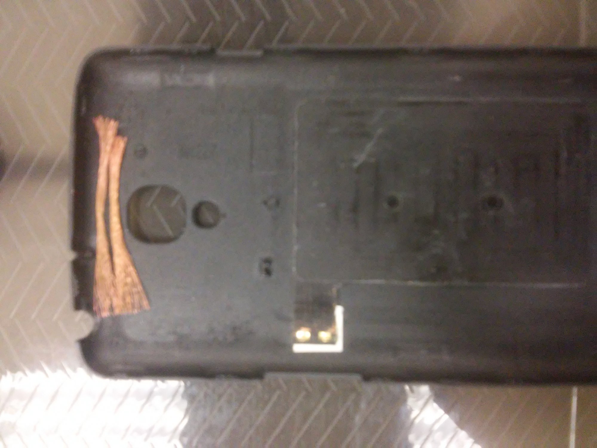

The problem with the LG Volt's GPS is that it gets poor satellite connections due to a weak internal gps antenna. You can fix the issue by layering some aluminum foil and cutting it to fit around the top of the rear-facing camera. I will attach pictures. I have tested this solution as well as implemented a modified gps.conf file, some of which I found at the beginning of this thread, and some of which I discovered by trial and error and thorough testing. Thanks to jfuginay for some of the working gps.conf file!!! I am getting excellent gps signals in the GPS Test appliction (even better or equal to my Samsung Galaxy) and I'm having a flawless gps experience now with my Volt. The picture of the signals displayed in the GPS Test application below are by no means the best signals that I get depending on my location, and only some of the signals are being shown. There are others as well. They are sometimes even better. Happy driving!!!

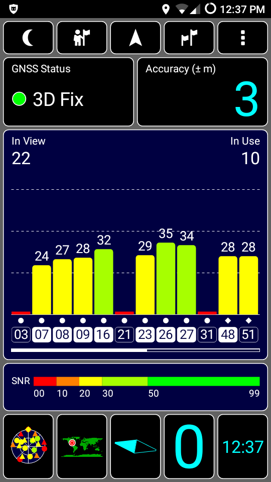

I found some copper soldering wick. It works way better than just regular aluminum foil. I'm getting some SNR signals close to 40 now....Go with copper tape, copper soldering wick, or copper wire if you can. See the SNR (signal to noise) ratio of each signal needs to be at least upper twenties to low thirties to get a fix and you need at least 3 satellite connections to keep a fix. The stock gps reciever in the Volt just isn't strong enough.
FYI, I got my copper tape in the mail today. It sucks. Copper soldering wick is the clear winner. All you do is double up a strand and cut it about an inch in length, then flatten out the ends. Place it just above the rear-facing camera under the battery cover. I'll upload a picture when I get home. It miraculously fixes the Volt's GPS problems.
