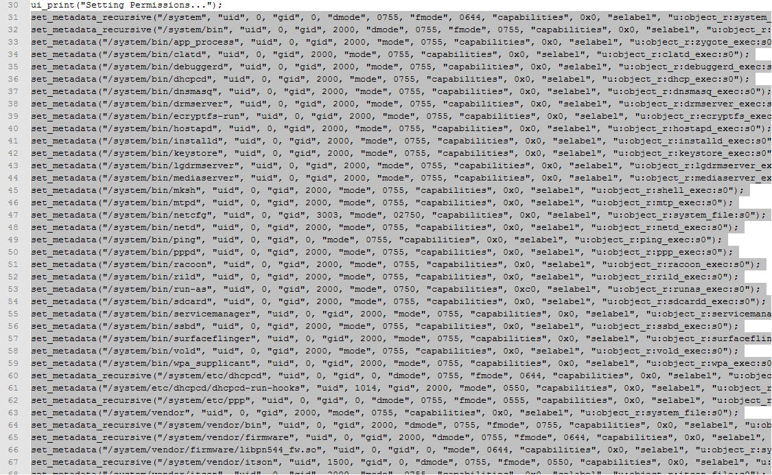

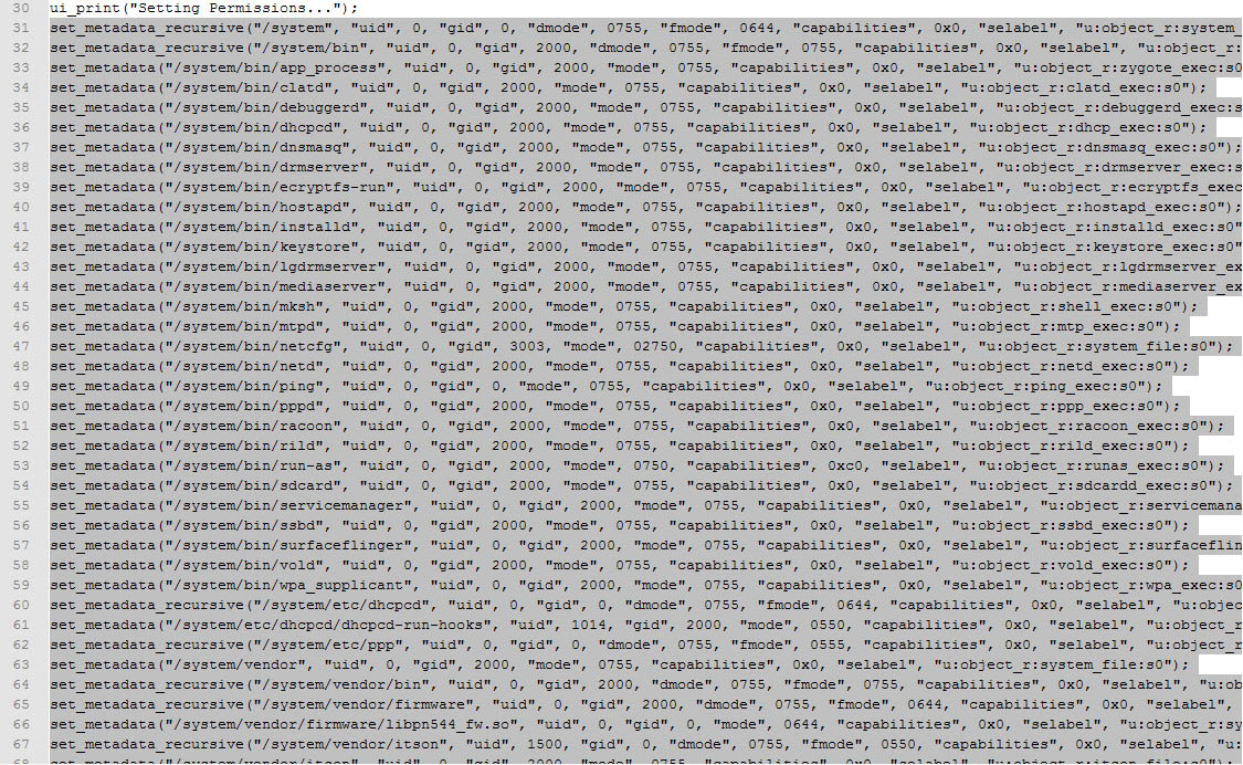

Step 3. We Will Start With Editing The Updater-Script (Located In Meta-Inf/Com/Google/Android Folder Of Base And Port Roms... First Open The Base Rom Updater Script In Notepad++. We Want To Edit All Lines You See In The Provided Picture Below (Mainly The Setting Permissions Lines..But You May See Something Near End Or Even At Start...Usually A Line Your Experience Tells You Needs To Be In The Base Roms Edited Updater-Script...Experience Here Is A Big Plus...). Open The Port Rom Updater-Script And Copy The Same Lines And Paste Them..Replacing The Base Roms Lines With Those From The Port Rom..Now There May Be Other Pertinent Items As All Roms Are Different. But In General These Are The Ones You Want To Change. You Will Have To Examine The Scripts. Anything That Looks As If It Needs To Be Added. Try It. May Result In Failure Of Script. But This Is What Porting Is. You Have To Try Many Things. Feel Free To Experiment.

I'm not picking or try to be rude. If you could, clean up step 3 so it's easier to read. That way newer users can easily follow along. Also the picture seems to be cut short, was there more to the pic?

All ports must stay within their android version. Cant use lets say a kit kat base for a lollipop port. wont work. step 3 is as clear as i can make it. you need to copy the set permissions section from updater script in port rom to the base rom updater script. nothing was cut off in image.
