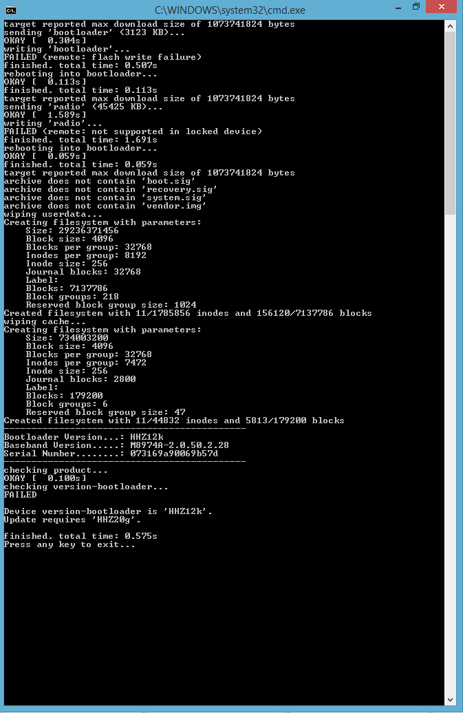

As to flashing the .IMG files directly via fastboot, this is what I get:
C:\Users\tedka\Desktop\Minimal ADB and Fastboot>fastboot devices
0745212c0063a116 fastboot
C:\Users\tedka\Desktop\Minimal ADB and Fastboot>fastboot oem unlock
OKAY [ 6.085s]
finished. total time: 6.160s
FAILED (remote: Already Unlocked)
finished. total time: 0.000s
C:\Users\tedka\Desktop\Minimal ADB and Fastboot>fastboot flash bootloader bootloader-hammerhead-hhz20f.img
target reported max download size of 1073741824 bytes
sending 'bootloader' (3120 KB)...
OKAY [ 0.239s]
writing 'bootloader'...
FAILED (remote: flash write failure)
finished. total time: 0.449s
C:\Users\tedka\Desktop\Minimal ADB and Fastboot>fastboot flash recovery recovery.img
sending 'recovery' (10004 KB)...
OKAY [ 0.504s]
writing 'recovery'...
finished. total time: 0.696s
C:\Users\tedka\Desktop\Minimal ADB and Fastboot>fastboot flash boot boot.img
sending 'boot' (9146 KB)...
OKAY [ 0.484s]
writing 'boot'...
finished. total time: 0.671s
C:\Users\tedka\Desktop\Minimal ADB and Fastboot>fastboot flash cache cache.img
erasing 'cache'...
FAILED (remote: failed to erase partition)
finished. total time: 0.130s
C:\Users\tedka\Desktop\Minimal ADB and Fastboot>fastboot flash userdata userdata
.img
erasing 'userdata'...
finished. total time: 0.179s
C:\Users\tedka\Desktop\Minimal ADB and Fastboot>fastboot flash system system.img
erasing 'system'...
finished. total time: 0.125s
C:\Users\tedka\Desktop\Minimal ADB and Fastboot>fastboot erase cache
******** Did you mean to fastboot format this ext4 partition?
erasing 'cache'...
finished. total time: 0.218s
C:\Users\tedka\Desktop\Minimal ADB and Fastboot>fastboot format cache
Creating filesystem with parameters:
Block size: 4096
Blocks per group: 32768
Inodes per group: 7472
Inode size: 256
Journal blocks: 2800
Label:
Blocks: 179200
Block groups: 6
Reserved block group size: 47
Created filesystem with 11/44832 inodes and 5813/179200 blocks
erasing 'cache'...
finished. total time: 0.172s
It is a pity that I did not take screenshots or copy the command line output the first time, when the erase commands return success one after the other. Now not only am I unable to push or pull files to/from the phone, but it also seems like I cannot erase or format anything either.
Any clues?

The E:failed to mount /cache (Invalid argument) appears on the bottom of the screen as soon as the phone enters in the Android Recovery menu. Seems like the partitions on the phone are messed up?
Smells like an eMMC problem? Something could've fried? After all, the phone did just shut off while reading a newspaper and that's where all the problems started. Actually unsure if there was an update going on meanwhile.

Everything looks identical to my first image posted, but when I enter the commands it still doesn't work, but when I run the actual flash.all.bat, I get a slightly different response. Instead of "error cannot load bootloader", It seems to work, but then it says "Failed <Remote not supported in locked device>.
http://imgur.com/JDescmn
Ah, that's a bit of progress :)...
I don't see the "Failed <Remote not supported in locked device>" in that most recent screenshot, though...
I do see
checking version-bootloader...
FAILED
Device version-bootloader is 'HHZ12k'.
Update requires 'HHz20g'.
which tells me that the bootloader didn't flash (is that where you saw the "Failed <Remote not supported in locked device>" message?)
Is your bootloader unlocked?
The "Failed" message is towards the top. I unlocked it yesterday with "fastboot oem unlock", but looking at my phone, it says "LOCK STATE - locked" which makes me think that it's locked? Could it be that restarting the bootloader caused it to lock itself again?
No, restarting the bootloader is fine and normal...
Normally, you should only have to do the "fastboot oem unlock" command and then you're golden...although we have seen some instances where this was not actually unlocking the bootloader for some people :(.
Also, can you do a "fastboot getvar all" command, please?
It should look something like this:

http://imgur.com/NDDqeZT it appears that the bootloader is locked
...and a "fastboot oem unlock" says/shows successful or not?
Try that again and then do the "fastboot getvar unlocked" command to show what the unlock status is afterwards.
Does your device still boot-up normally? If so, you could try sideloading (via adb) the most current block OTA on your device, using the instructions in this page:
and using this file:
that should amount to the same as flashing a factory image (same/most recent version).

Unfortunately I don't think it would boot up. My device was stuck in a bootloop around the four spinning dots with the android logo, so I thought that I would resset it to factory settings.
I then tried to do the commands again, and it still says "error cannot load bootloader-hammerhead-hhz20g"
After that, I ran the flash.all.bat file, and it says something different as an error, but then once it continues for the radio file, my phone bootloader goes back into the locked state.
