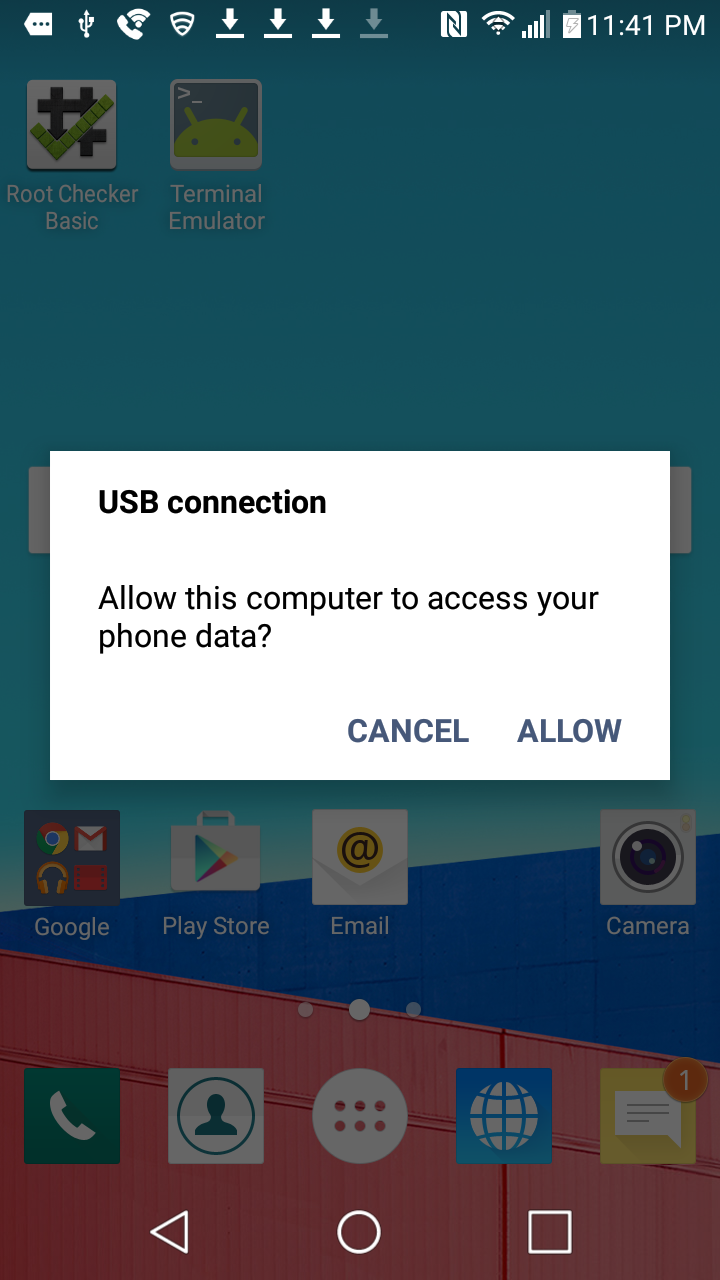

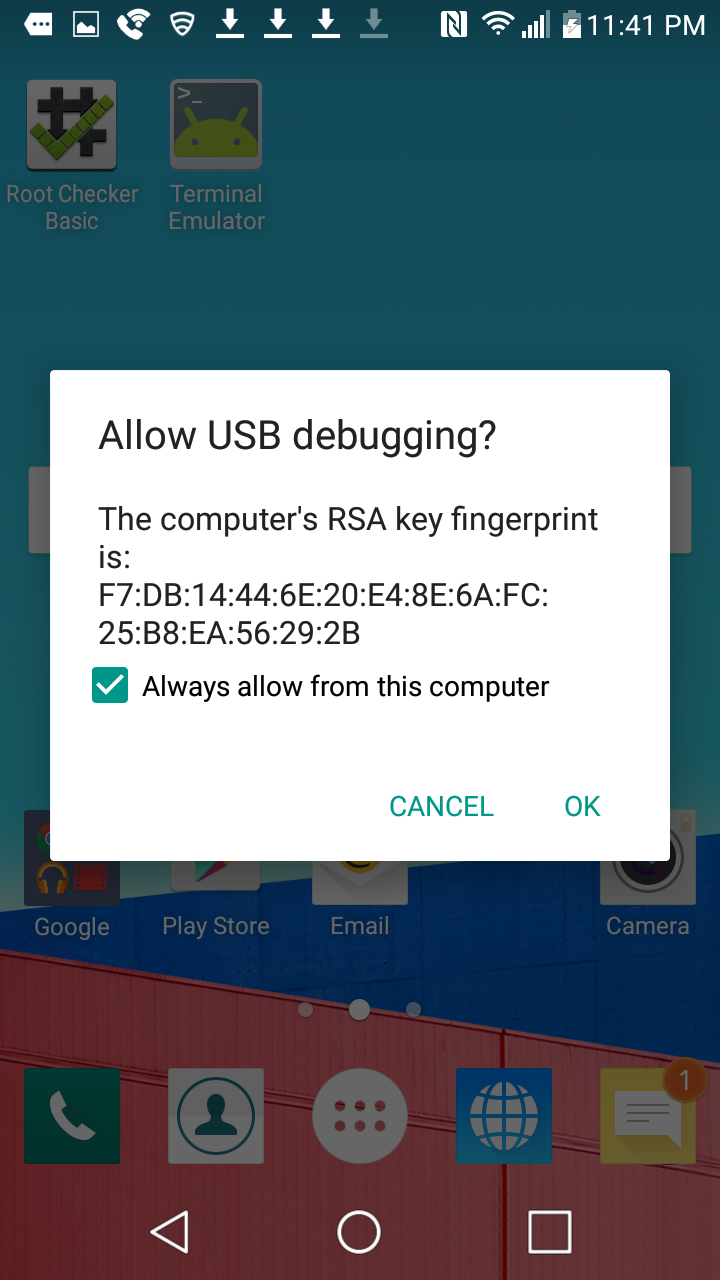

Just as a curiousity, would it work on a vm? I can create a bootable ubuntu drive. Or dual boot into kali. I tried my wifes pc (win xp) and had the same issues. These are the pop ups on my phone @TMacgnolia

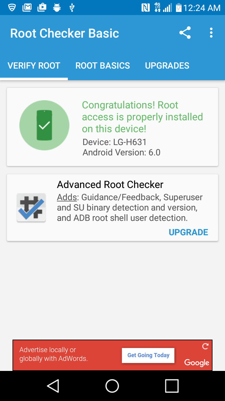

i uninstalled adb and fastboot, revoked usb debugging authorizations, and uninstalled all lg drivers i had on my pc. Then reinstalled the latest drivers @TMacgnolia linked me to, reinstalled adb and fastboot, and enabled usb debugging. I allowed the Rsa toast, and tried again. Everything worked, up to fastboot flash recovery recovery.img, so i used fastboot boot recovery.img, booted into twrp, flashed supersu, (when twrp asks to install supersu say no!)and rebooted system. I then used flashify to flash twrp, and made a backup.
