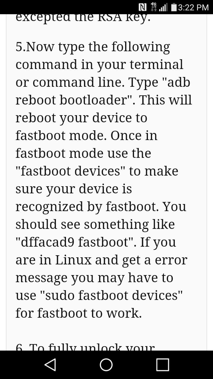

I do this to the Tee. Once i reboot bootloader, my device boots to fastboot mode. (lg splash screen). If i type fastboot devices, nothing.
