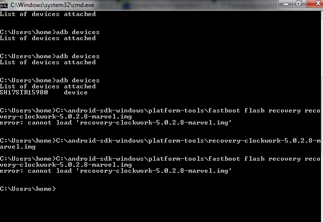

I have followed the steps but still no joy, i have rebooted the phone into HBOOT, the screen reads Fastboot USB as required.
the Img file is located in my Android folder where the fastboot.exe sits.(hope this is the correct place)
i have put the text into CMD but still getting the same error. any ideas

I'm thinking there's an error somewhere. Either in the location path or the name of the file. Make sure everything is typed correctly

Looking at the instructions i is typed correctly, is my img file in the correct location? i have it in android- platform tools.
if so once im in fastboot USB, WHAT EXACTLY do i need to type in CMD

Hi Joemoore22,
As I see your attach file image, you put the recovery image somewhere and executed the command on somewhere. put all in the one folder and proceed.
Just create a folder on "C:\android " and copy ONLY adb.exe, AdbWinApi.dll and fastboot.exe along with your <clockworkmod.img> file.
Now type the same fastboot command from "C:\android" as I explained earlier......
and this will definitely flash the recovery on the device!!.

Thanks for your help im still getting the same error,
when the phone is in hboot should the device come up in the list off attched devices when 'ADB DEVICES' is typed into CMD? i only get the device show up when on in normal mode,
if anyone has any ideas i would be greatful, maybe i have a file missing somewhere?
