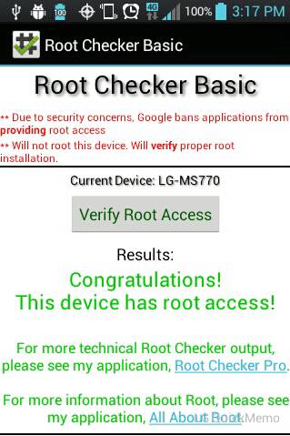

I had to uninstall system backup and reinstall. I am rooted now I.gave up for a while doing it til some one on youtube said try reinstalling the back up thanks..also what's an apk? Do i need it?
Make sure you reboot after installing the apk. Step 7 :D
ok I rebooted the PC. It worked. I think. I had supersu and was able to use my phone for about 30 minutes.
