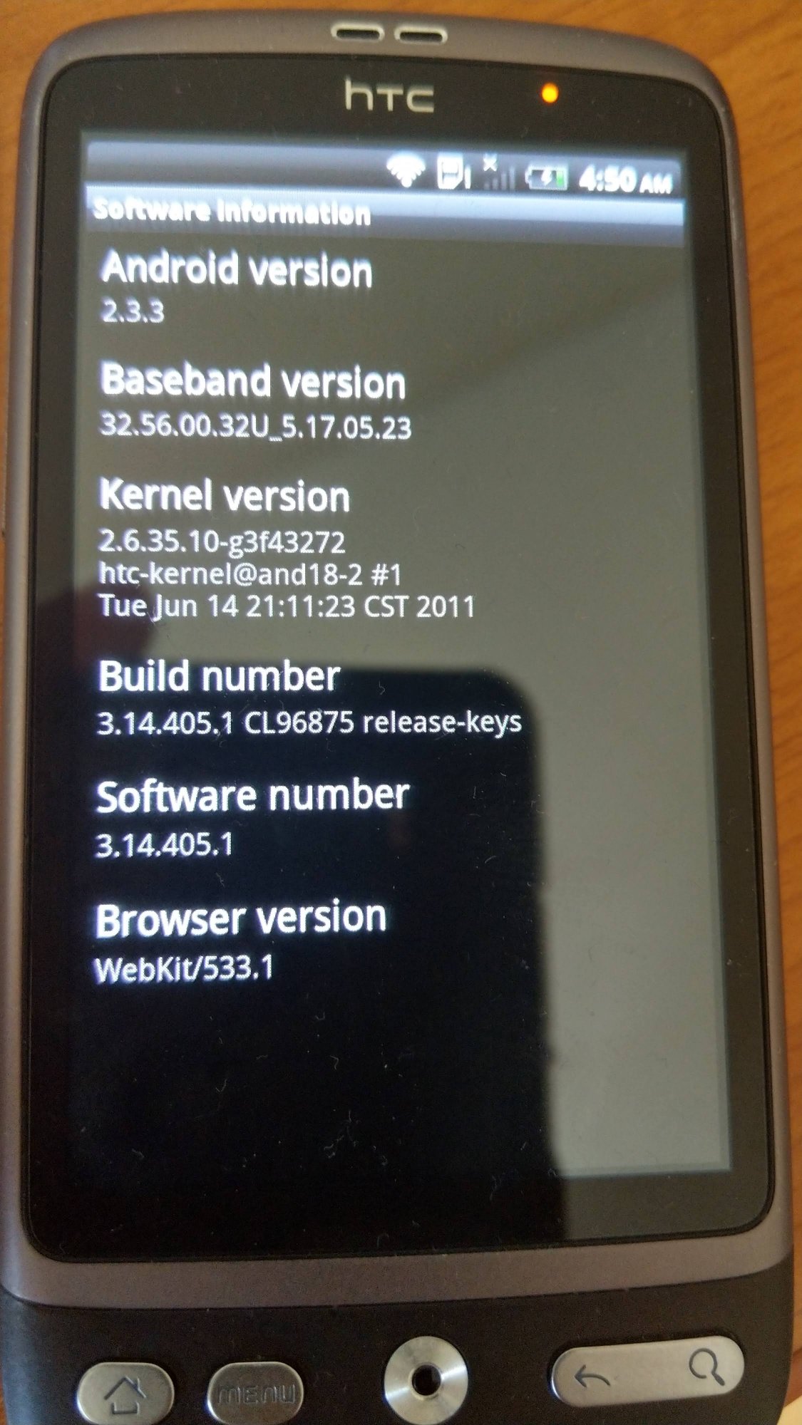

this is the bastard .
OK, yes, that's a Bravo all right (the original Desire). In fact that's the first hardware revision, same as mine was.

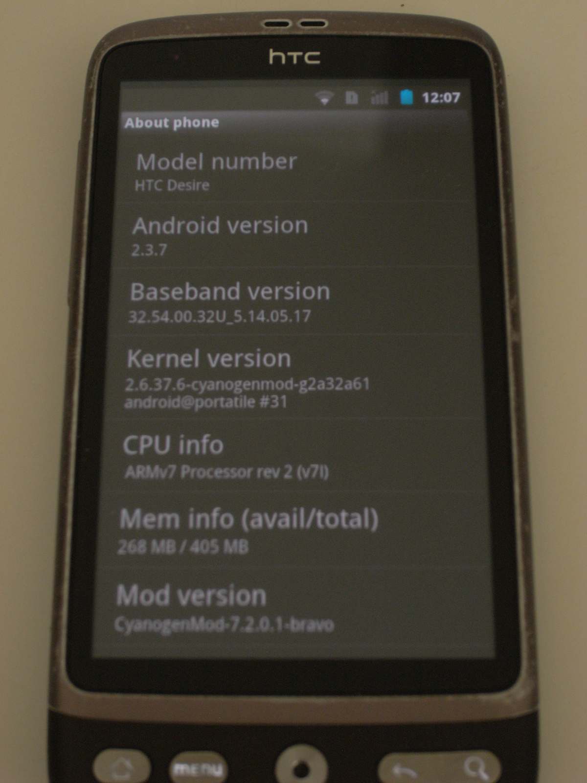

I'm trying to revive my HTC Desire, starting with S-Off.
Mine is running an old version of Cyanogenmod and i would like to try something a bit newer. So far I have been unable to start any recovery image and while I can run Unrevoked, it aborts saying "Error: failed to get root. Is your firmware too new?".

you most likely have a newer firmware that unrevoked will not work on. what is your firmware version?
wait i'm confused. you have s-on yet you have Cyanogenmod on the phone? how is that possible? and what do you mean by "unable to start any recovery image"? you cannot install custom recovery unless you have s-off first.
Unrevoked won't work because you are already running a custom ROM. The rest of the firmware is actually very old - looks like it was never updated after purchase (probably because it was rooted and a custom ROM stuck on it very early on).
Indeed, that's how it was. I rooted it soon after I bought it and it hasn't seen any official HTC software ever since...

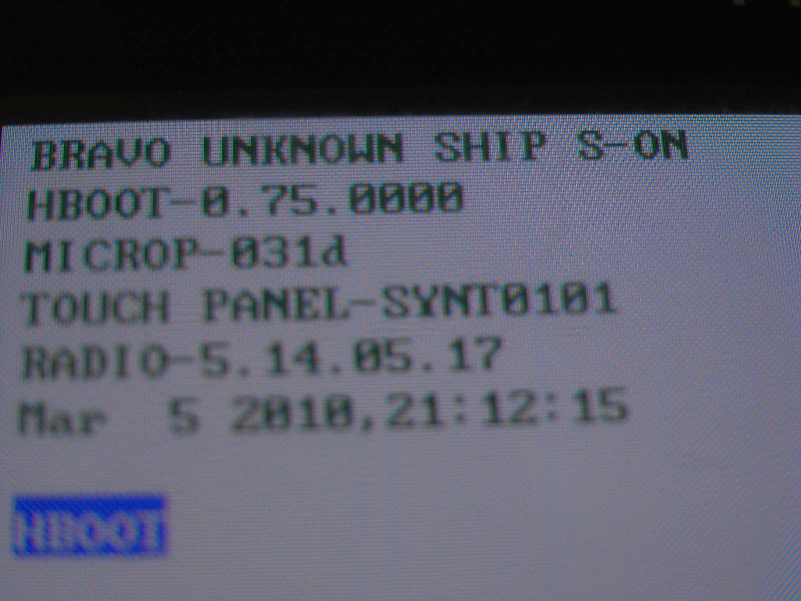

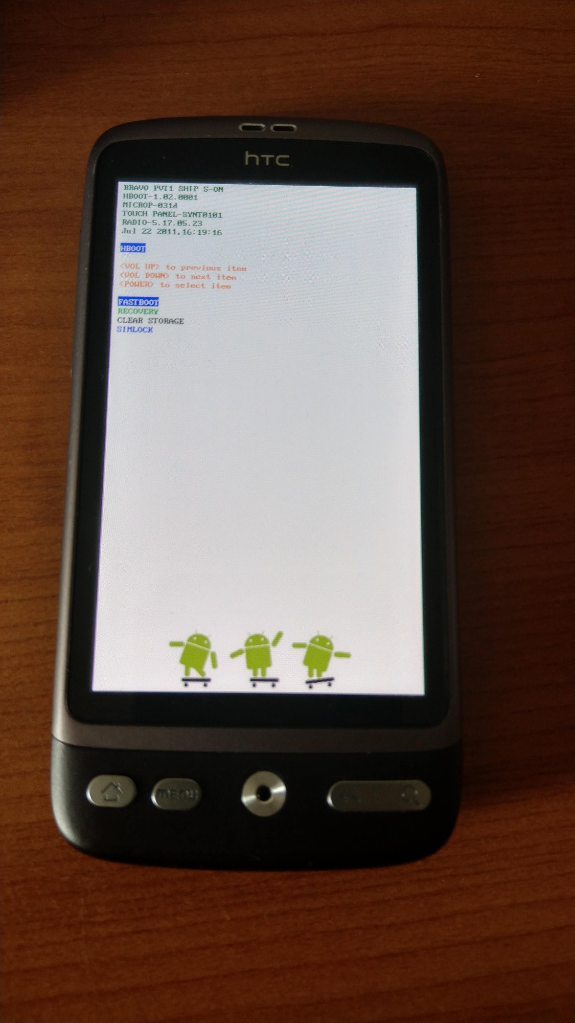

Ah excellent, that way I do get a menu. I did manage to install some RUUs but none that were older than the cyanogenmod version I had installed. Plus in the process I seem to have upgraded my HBOOT which, I think, is a bad thing.
I did manage to download revolutionary, unfortunately their website is down and now handing out any more keys, so I would appear to be out of luck for now...
I don't think that the problem when running CM was that firmware was too new, it was that you had CM. The rest of the firmware was very old. So it depends on how far you updated the hboot. There is a catch-22 here though: you cannot flash an RUU with older firmware unless you are already S-Off.
I'd forgotten about tokens for revolutionary though. Yeah, that one is hopeless then.
HBOOT is at version 1.02 now and I'm still getting the same error message from revolutionary. I also managed to find bootable ISO of alpharev S-OFF but that one doesn't work either, seems it can't figure out the device's current software version.
