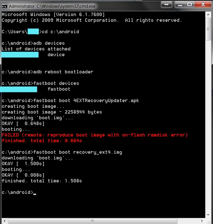

wanted you to check this screenie cos it showed an error when i flashboot booted ext4 - by complete fluke, i decided to try to load the recovery and my phone booted into ext4 - not sure of the explanation for that but i thought i'd let you know in case someone was stuck after trying to flashboot boot ext4

you needed to fastboot boot the image,as you did the 2nd time when it was successful.GARRRRRR - Scotty help!!!!
