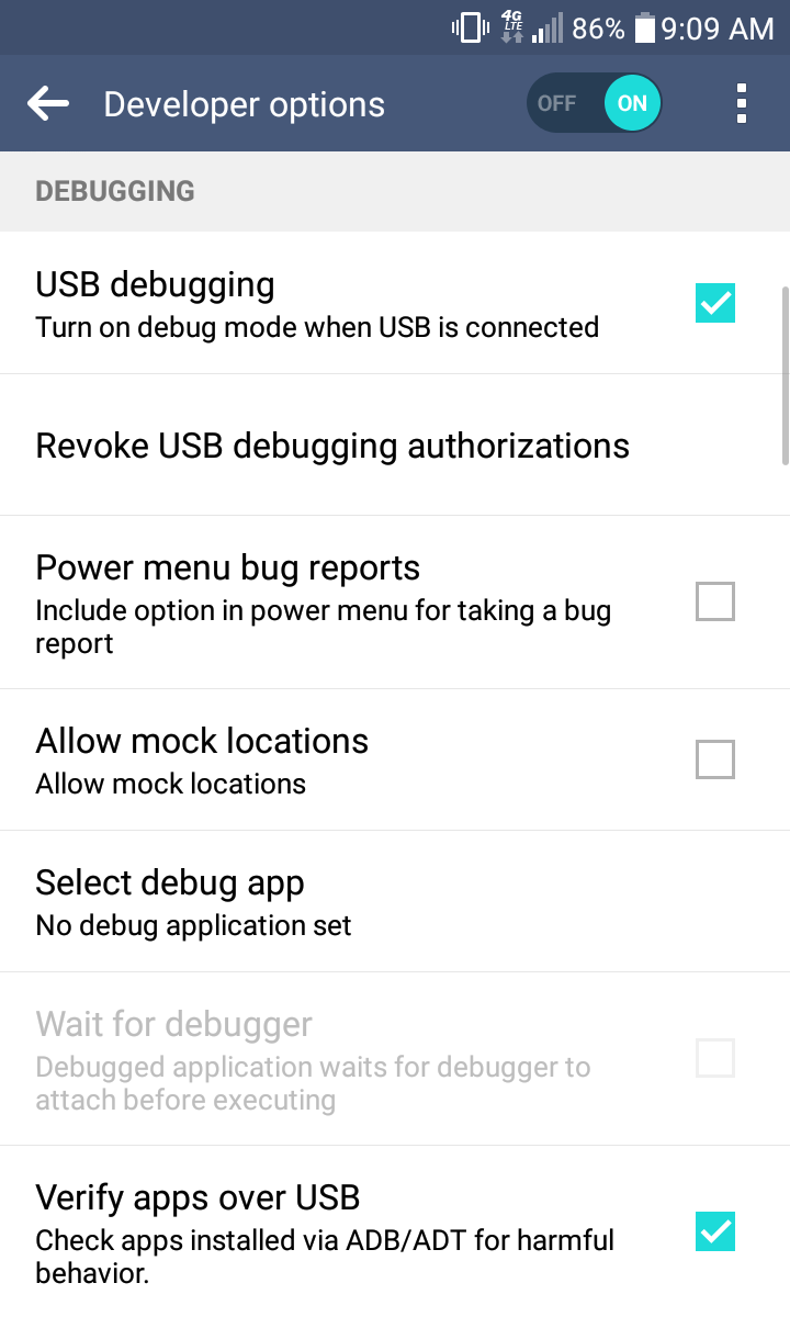

Enable USB debugging, revoke debugging permissions, then plug your phone into your pc and run the script, it should ask for debugging permission, check to always allow and grant it.
