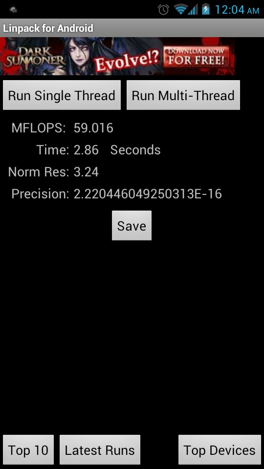

What's your benchmark score?
Not nearly as high benchmark scores as I had on some sense roms but I feel that CM9 DT with Anthrax 3.0.4 is the fastest, smoothest rom I've used so far. I have the gpu oc'd too. Man this thing flies.
