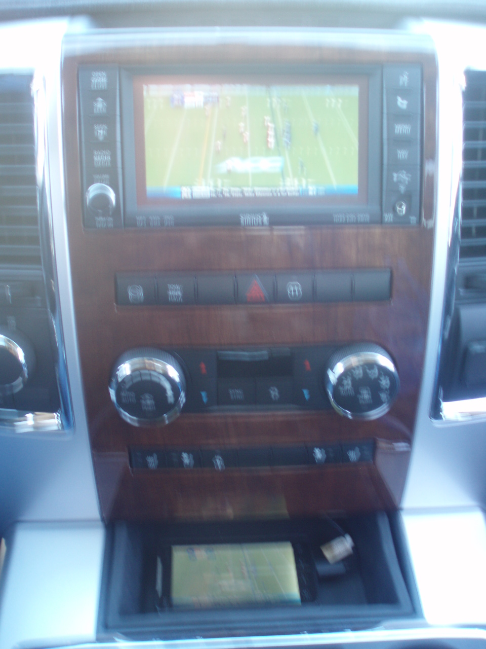

Alright after doing some research this is what I've come up with, first the parts I am using to make this happen:
Sanoxy HDMI to Composite/S-Video Converter 3RCA CRT TV CVBS
Cobra CPI 880 800 Watt 12 Volt DC to 120 Volt AC Power Inverter with 5 Volt USB output (got this size because I can power up a PS II)
CHR550 LOCKPICK (used in Dodge, other are Lockpicks available)
I have DISH network at home, I use the slingbox adapter with my receiver and I can watch TV from my own dish from anywhere as long as I have Internet (just download the DISH app). I'm still waiting on all the parts but I will let you guys know how it works out.

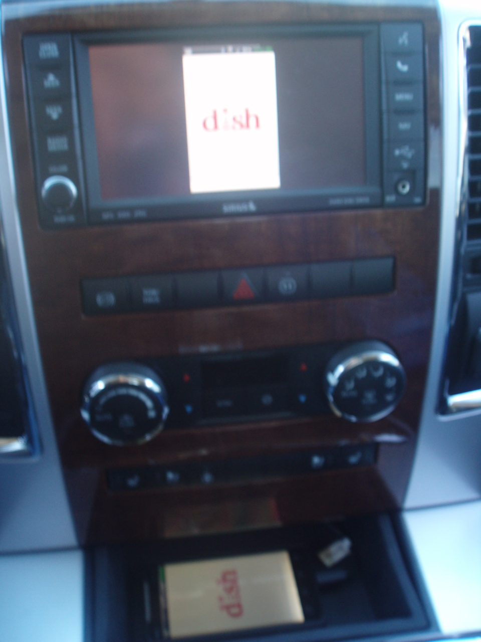

Changed some things up but I have it working. First of all, the first HDMI converter I got was bad so I bought another one from Ebay, then for a power source I tapped into 12volt power supply that works off the accessory on the key and use a 75 watt plug in inverter. I have a sling adapter hooked up to my DVR via DISH network. I can watch my own TV anywhere now as long as I have 3G/4G connection. The RCA's plug into the Lockpick that send the signal to the head unit.
