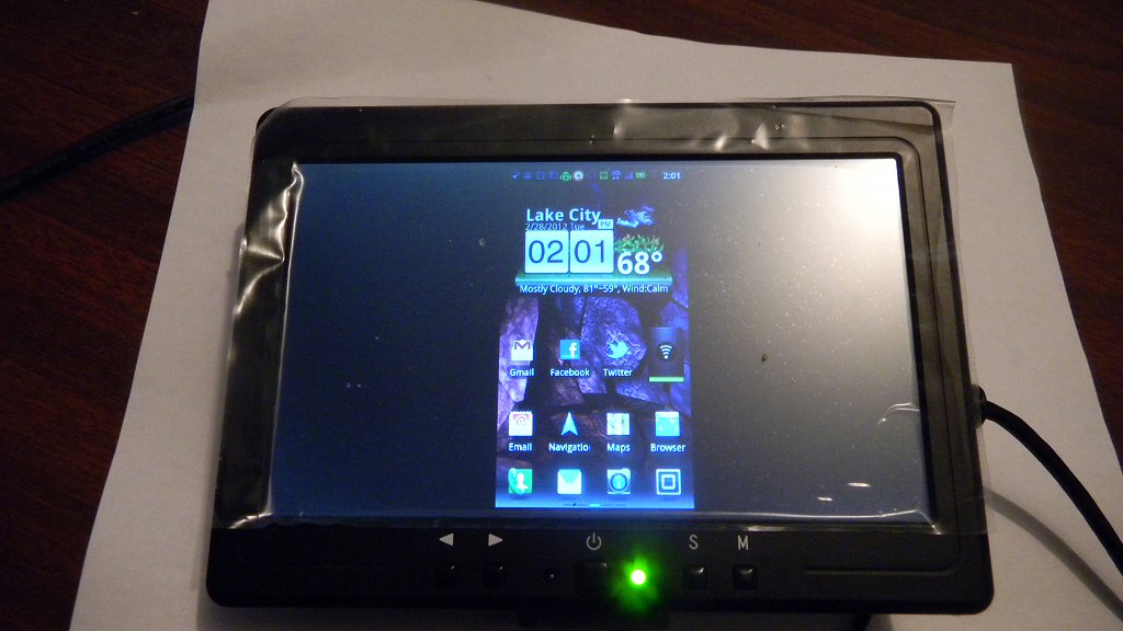

I bought a 7" HDMI monitor to use with my Bionic. When I plug it in, it works but the phone is in the middle of the screen, which is in landscape mode but the phone is in portrait mode (see Pic-1). This is useless to me for my application.

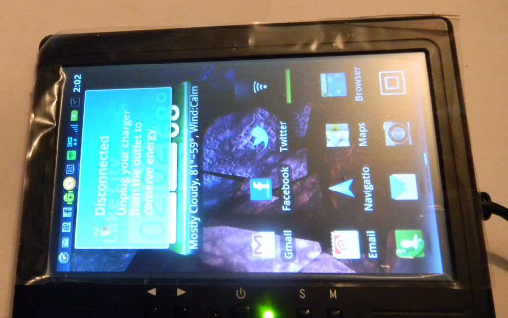

Is there any way I can force the HDMI output into portrait mode so it looks like my cell phone (see Pic-2)? I did call the manufacture and they said I need to make the changes in the phone's HDMI video driver.

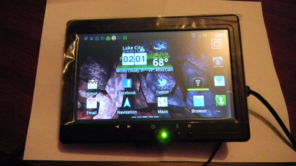

When I rotate the phone from portrait mode to landscape mode the HDMI monitor shows the phone's image like I want it for just a second (see Pic-2) then goes into landscape mode (see Pic-3).
The problem with locking the phone in landscape mode is that many apps force the screen back into portrait mode. Navigation is one app that I need to be in portrait mode but the HDMI monitor switches back to landscape mode.

[to be clear, Pic-1 is how it is now, Pic-3 is how it looks when the phone is in landscape mode. When navigation is on, the screen goes back to Pic-1 style. Pic-2 is what I want the external monitor to look like when the phone is in portrait (normal) mode.

I think there is some confusion here. It sounds like the OP wants to mount the external monitor in a portrait orientation, so that the physical monitor is taller than it is wide, and have the portrait-orientation phone display fill the external screen. Imagine all the pics shown so far rotated 90 degrees clockwise and you'll understand better.
The problem is that the display mirroring of the Bionic assumes that the external monitor is in a landscape orientation, so when it's mirroring a portrait-oriented display, it shows up on the external display as shown in the first pic.
I don't know of any way to address this issue, but wanted to clear up the confusion so that others can better understand the problem.

EXACTLY! But I do know it can display as I desire because it does it for 1 second while changing from portrait to landscape mode on the phone (as seen in Pic-2
