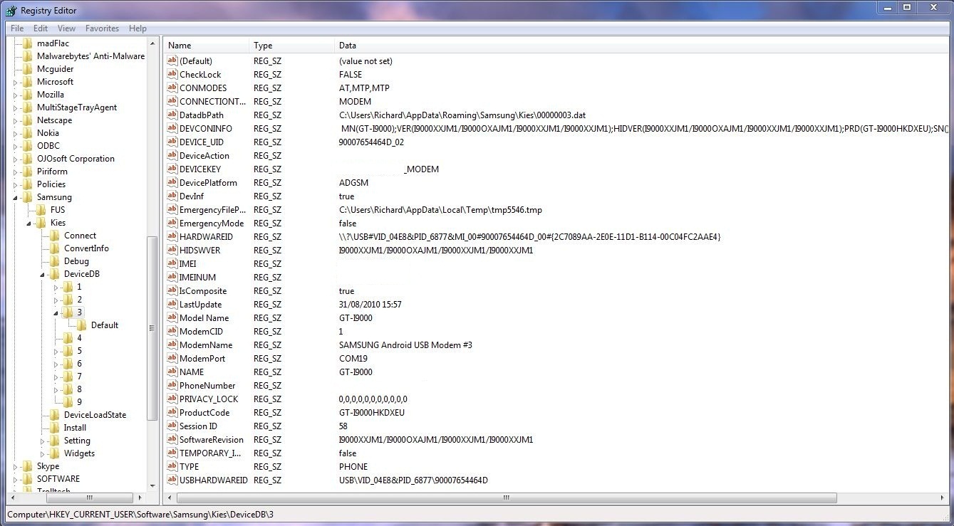

If you edit your reg files it should look like the pic. save the text thats there before you edit as you may need it to update to froyo when that is relaised.
the JM1 firmware has fixed my issues wit kies hope it works for you too
My regedit looks nothing like this!!

HKey_current_user\Software\Samsun\Kies\DeviceDB\12
Note the number at the end could be anything so you will need to look through
This key you are looking for will contain the following value:
"Product Code"= "GT-I9000KHDCPW"
The CPW bit is the key information (at least for my device).
As this is an HKey_current _user setting it is only there when Kies is running and the device connected.
Now apparently (and I don't know whether this works), if you change the registry entry to the value GT-I9000HKDXEU (again only for UK) and close the registry and then try the firmware update (all while still running Kies ovbviously), Kies will now think you have a stock ROM and offer the ROM upgrade to JM1.
I will try this when I get a chance and feed back if it works. But at least it may offer an explanation and/or workaround.

This is also something that worked for me. Look for DEVCONINFO, follow it along to the right until you find PDR, this is also the product code. Double click DEVCONINFO, A box will pop up and the contents will be high lighted, remove the high light and use the left and right keys to move to the right until you find PDR then change the last 3 letters to XEU (UK) and then click on OK
Do the same with the product code further down.
The ones you are looking for I have marked with a red outline.
This may help

open kies and connect your phone,
open regedit,
kies should already be shown, if not this is the registry key HKey_current_user\Software\Samsung\Kies\DeviceDB\1 2(this number may vary)
under kies there are sub folders 1, 2, ect click on each one in turn and check the right hand pane until you find the product code/sales code, double click it and change the last 3 letters from what you have now VOD to XEU(for the UK)
close regedit and go back to kies and click on firmware update and then ctrl+ant+U+P this will put kies into test mode it should now show a update to JM1.
REMEMBER WHILE DOING THE ABOVE TO KEEP KIES RUNNING AND YOUR PHONE CONNECTED
