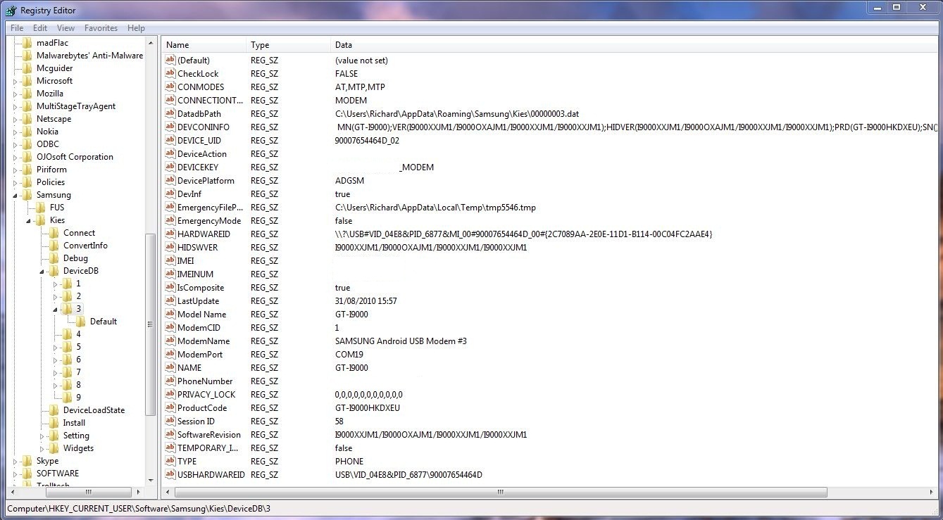

My regedit looks nothing like this!!
Admittedly I am having problems connecting to Kies - STILL! - so it probably has something to do with that.
When I try to connect the phone and go into regedit I do get a similar screen as above but my folders are numbered 1,2,3,4. None of them contain lines titled 'product code' or 'software revision' or 'hidswver', basically anything that mentions a firmware code so obviously Im unable to edit them :(

Ok first of all the numbers at the side dont make a difference they will always be 1234 if you only connect one phone to your kies if you connect a second phone they will be 5678 and so on.
Second if your phone is not deceted by kies the reg file will not show product code, hidswver or software revision
I suggest you connect your phone go to device manager and uninstall the drivers, disconnected and start kies reconnect your phone and wait till new drivers install when the phone shows up in kies open regedit
Also DEVCONINFO can be left blank and kies will auto rebuild this when it installs the firmware

If this doesn't work try the registry:
open kies and connect your phone,
open regedit,
kies should already be shown, if not this is the registry key HKey_current_user\Software\Samsung\Kies\DeviceDB\1 2(this number may vary)
under kies there are sub folders 1, 2, ect click on each one in turn and check the right hand pane until you find the product code/sales code, double click it and change the last 3 letters from what you have now VOD to XEU(for the UK)
close regedit and go back to kies and click on firmware update and then ctrl+ant+U+P this will put kies into test mode it should now show a update to JM1.
REMEMBER WHILE DOING THE ABOVE TO KEEP KIES RUNNING AND YOUR PHONE CONNECTED

Windows Registry Editor Version 5.00
[HKEY_CURRENT_USER\Software\Samsung\Kies\DeviceDB\4]
"SoftwareRevision"="I9000XXJF3/I9000OXAJF3/I9000XXJF3/I9000XXJF3"
"ProductCode"="GT-I9000HKDXEU"
"HIDSWVER"="I9000XXJF3/I9000OXAJF3/I9000XXJF3/I9000XXJF3"
"DEVCONINFO"=""
Copy and paste that into a Notepad doc and save as XEU.reg do not execute this file yet! With your phone connected and kies open go to regedit, go to HKEY_CURRENT_USER\Software\Samsung\Kies\DeviceDB and check what folder your phone is in(your phone is the only folder containing phone number)
if this folder is number 4 then just execute the registry file XEU.reg if its not number 4 then right click on the the registry file XEU.reg and select edit and change number 4 in this line: [HKEY_CURRENT_USER\Software\Samsung\Kies\DeviceDB\4] to the correct one save the and execute it.
then go to kies and check for firmware update.

I have tried the registry hack after changing my phone code from CPW to XEU. I changed the product code in the registry and also the deviceinfo to XEU and was offered the upgrade from JF3 to JM1. The phone flashed ok with no problem and now has JM1 firmware. My problem is that now if I check for firmware upgrade kies tells me that the phone cannot be upgraded. Checking the registry the product code has reverted to CPW. Does this mean that everytime I want to check for a firmware upgrade I will need to go into the registry and make these changes each time or is there a way of making the registry hack permanent?
Hi there,
I don't know if this will work for you but this is what I did:
Make all the changes again in the registry
and then go to file> export (choose desktop to export it to)
close the registry down and then reopen it, make sure regedit is open on the same part you have just edited and then go to file> import, select the reg file from the desktop.
Because it is a registry file it should make it permanent
hope it helps

Thanks for this info, however I must be doing something wrong. Please advise which file I need to export, because the files I have tried to export brings up the eror message, not a proper registry file and I cannot save to the desktop
See attachment, this is what you should see. This is where you have changed the product code ect, once you have done all the changes then go to file and export it to desktop and then import it.
Don't forget under kies you will have other folders and then numbered folders, in the numbered folders you will find the keys to change, in my case it is folder 3, but this doe's vary, as long as you can see the same info as in attachment you should be ok.

Thanks guys changing the product code worked, now running JM1. Does seem better than JF3 (although wasn't suffering with much lag)
Thanks stylelite would never had thought to look there!!
