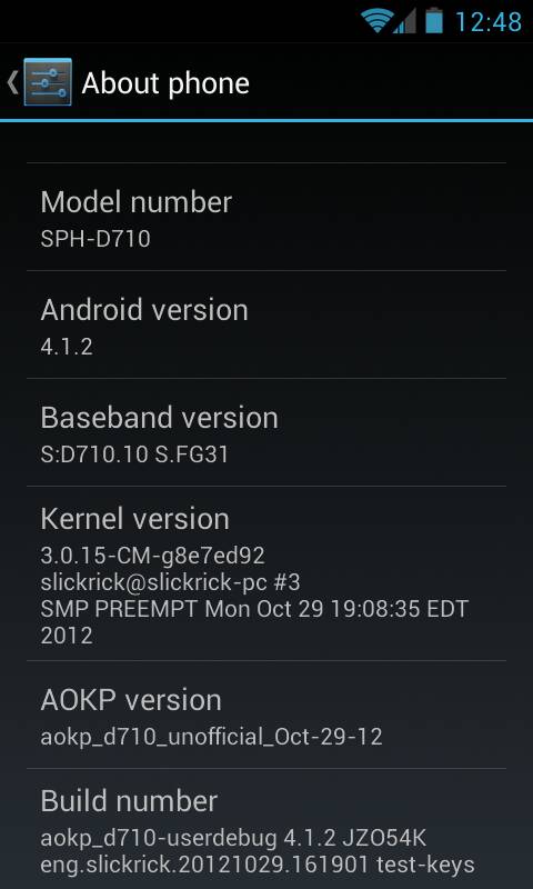

Attached a screen shot of my about screen to kind of give you a basic idea. Since AOKP is based off of CM you can use the CM kernel without issue.
