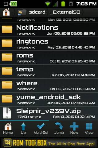

The rom is located here.
You're on the stock ROM, correct? And rooted, and have Superuser or SuperSU (it's free and improved brother)?
Then, based on "applet not found," I'm going to guess you do not yet have BusyBox. Download and install BusyBox from the Play Store. Open BusyBox once it's been downloaded and installed, and tell it to do a Normal (not Smart) install. Then try verifying the MD5Sum :p

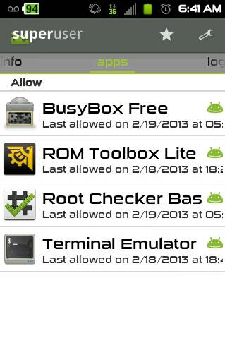

I've installed busybox and have done all the steps in your tutorial up to the flashing the rom.
What do you mean when you say stock rom? Also this picture shows I have busybox.

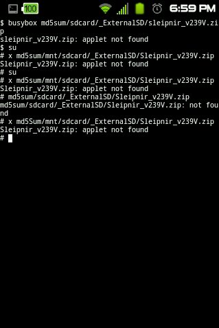

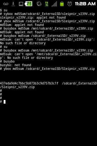

Here is some more screen shots, If they help at all.

There should be a space between md5sum and the file location. I'd say Artine is right, though, reinstall busybox and see if that helps. Do a normal install from inside the busybox installer app, even if you've done it before just to be sure that everything is where it should be.
edit... or try this: https://play.google.com/store/apps/details?id=com.fab.md5
Thanks I think I did it! What now? Is it good?
Well compare the md5sum that it generated to the one in the original post. If it's the same then you are good to go. Always be sure to make a nandroid backup tho in recovery before you flash the ROM :)
Ahh thanks a ton! But... it dose not match. What did I do wrong. :eek::(
Nothing, you just need to re-download it either with a computer and transfer it to your phone via the charging cable, or download it directly with your phone using either Dolphin Browser or Google Chrome, but not the stock browser as it can't handle it properly (usually corrupts the data in-transit) :) If the MD5Sums do not match, it's because the data corrupted in-transit to your device receiving the data. Verifying the MD5 tells you whether or not the copy of the ROM you downloaded, is in fact, part-for-part, the ROM that was uploaded. If they match, you're good to go, if not, try downloading it again (and in the case of Sleipnir, make sure to read the installation instructions and also download the version of the ROM appropriate for your Carrier, if you have VM get the VM version, if you have Sprint get the Sprint version).

They matched up! Success!
Ahh i was looking at the new version's md5 and i have v239V thats why the md5 was wrong. So after just
