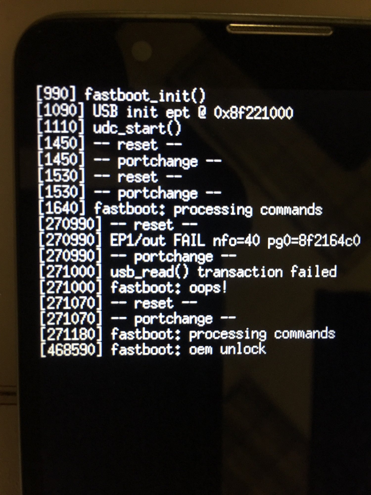

I wiped the laf partition yesterday. Now when I got to download mode I get this:
fastboot_init()
USB init ept @0x08f221000
udc_start()
-- reset --
-- portchange --
I couldn't get my windows PC at home to recognize the driver, but my ubuntu machine does. Ran fastboot oem unlock and phone currently says fastboot: processing commands. Terminal still says waiting for device.
If I wasn't a complete newb, I would know if this was good or not. Image is attached.
Edit: I ran sudo fastboot devices and it sees the device. Ran sudo fastboot oem unlock and it says FAILED (remote: unknown command.) Tried sudo fastboot flashing unlock and I Terminal says < waiting for device > but phone shows fastboot: oem unlock. Seems to stall there.
Re-Edit: I reset terminal and tried sudo fastboot flashing unlock and it seems that is not an actual command as it is unrecognized. Not sure why it would return unknown command for oem unlock. o_O
