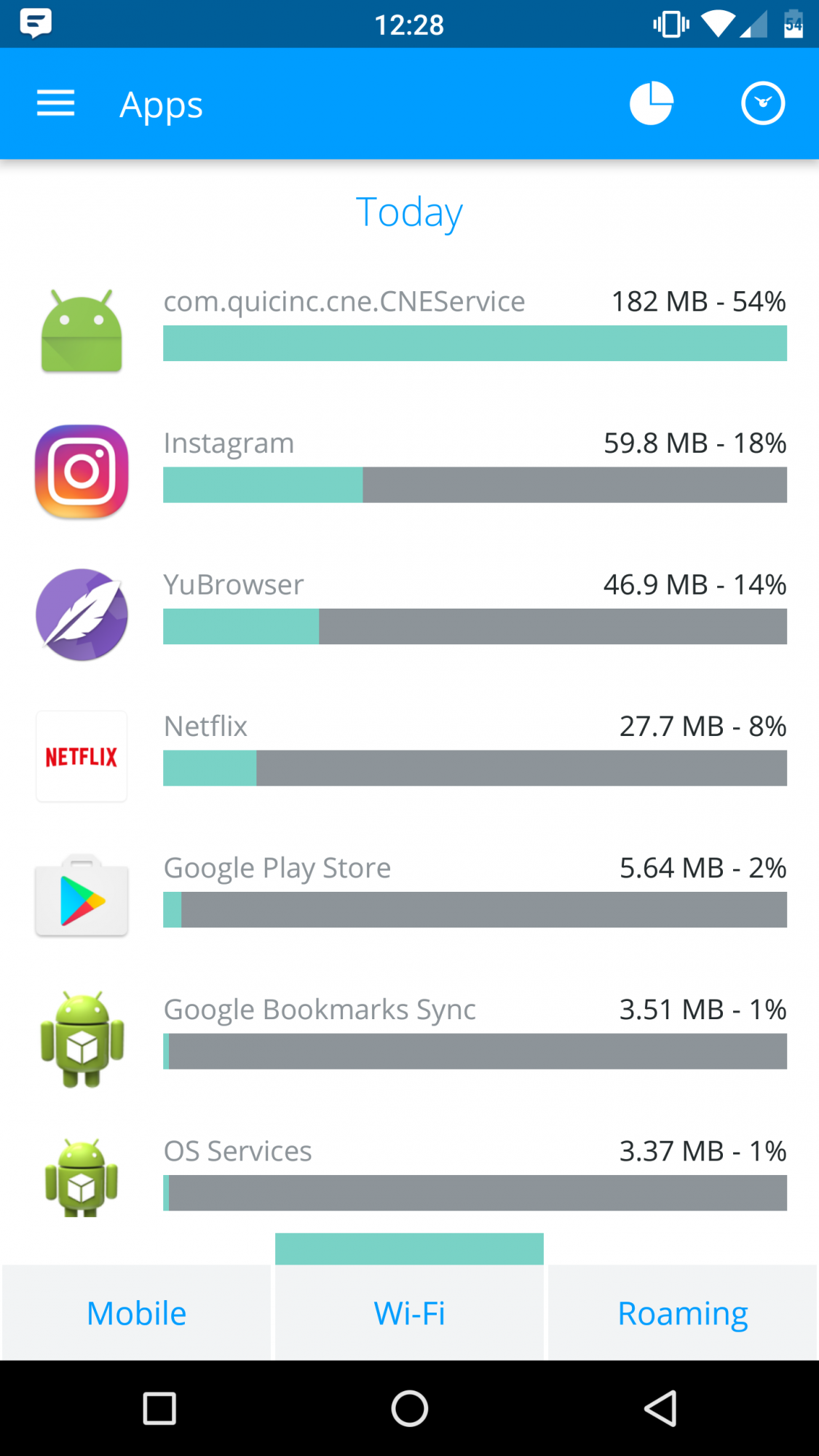

I may have found a culprit for mass amount of background data being used by Android OS. My nexus 6p used around 500mb in one day and i had no idea why. I downloaded a data manager app and found out what it was, but i don't know how to fix it!
Every time I reboot my phone, com.quicinc.cne.CNESERVICE (qualcomms connectivity engine) usesabout 100mb of background data. So one day when I was out and messing with my phone, rebooting in between 5 times, it used tons of data.
I does it at home on wifi too, not just on mobile data. Here's a screenshot after rebooting twice. If I dont reboot, it doesnt use any data.

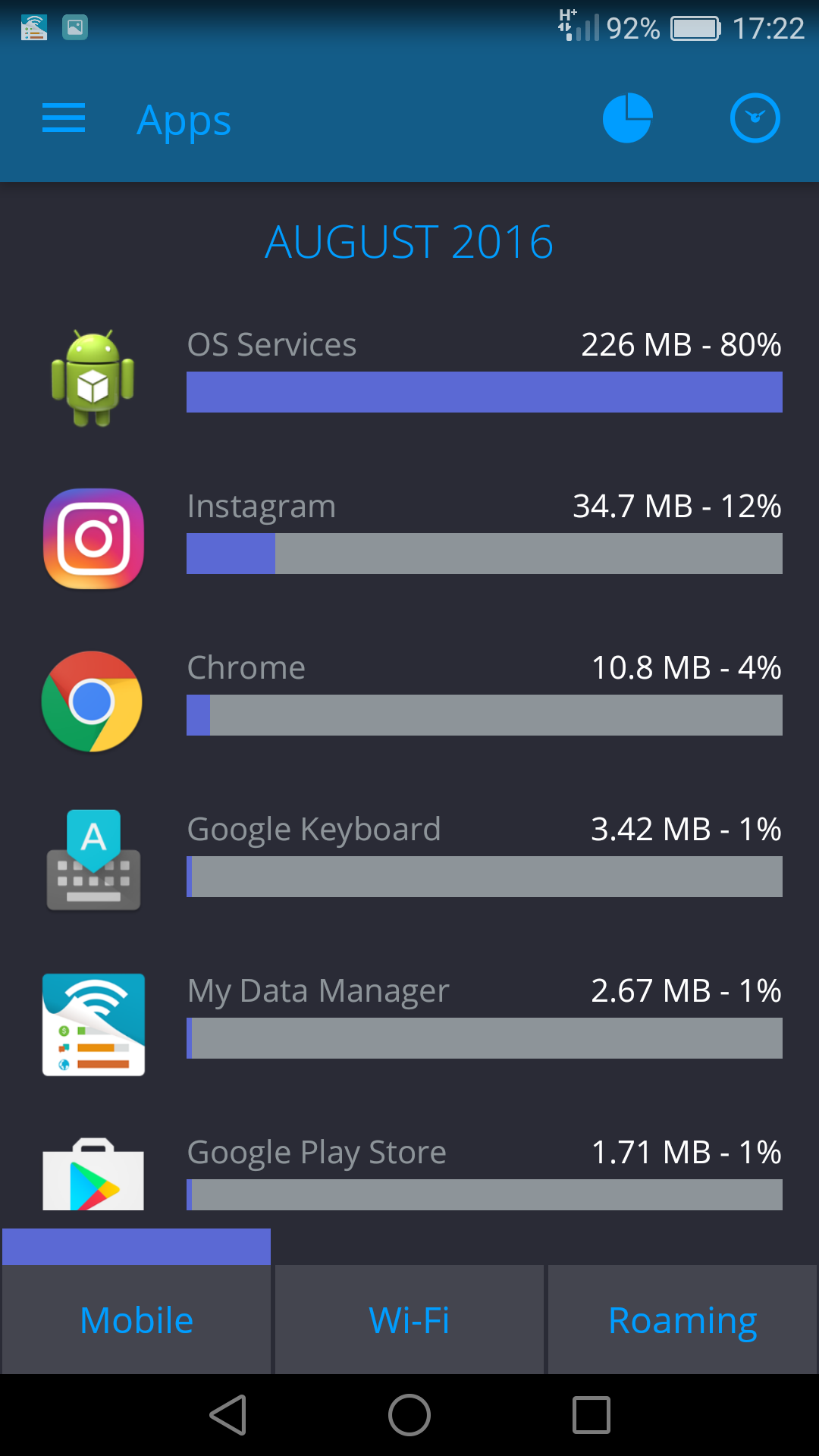

in the last three days my huawei p9 has happily used 227mb on OS services according to "My Data Manager" . This matches what my provider thinks I have used... however if I look at the built in data manager it hardly shows any OS traffic at all

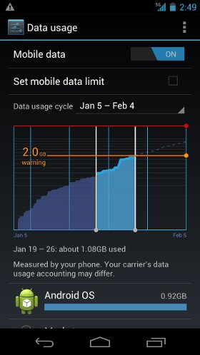

Hi Everyone,
I just got a warning about my data limit from T-Mobile saying that I hit the 2Gb limit. I thought that this was kind of strange because I don't use that much data via 3g/4g because I am around WiFi most of the day!
I check the data monitor on my GNex and this is what I saw! In the space of one week, Android OS used almost a GIG of data!
Has anyone else out there had this sort of data consumption?!? Does anyone have a clue as to what could be the culprit?
