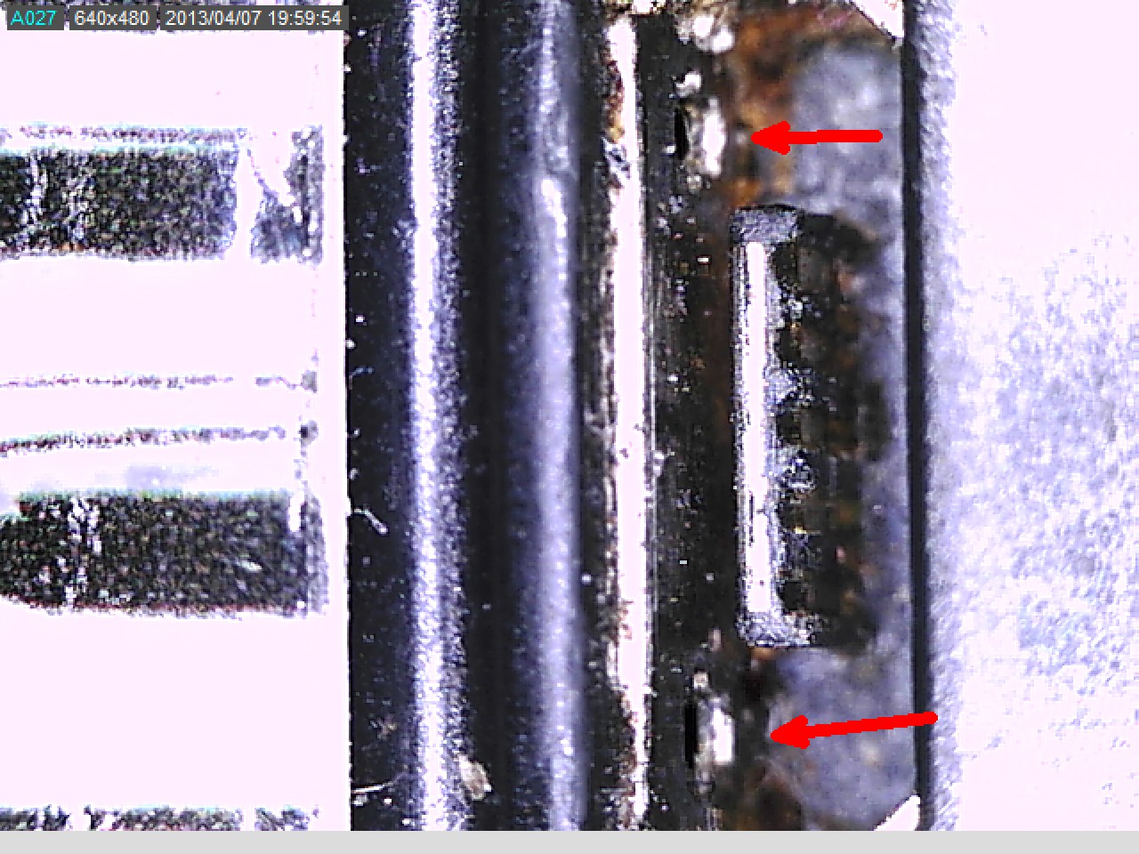

you can try bending the two places a little marked in the pic.
