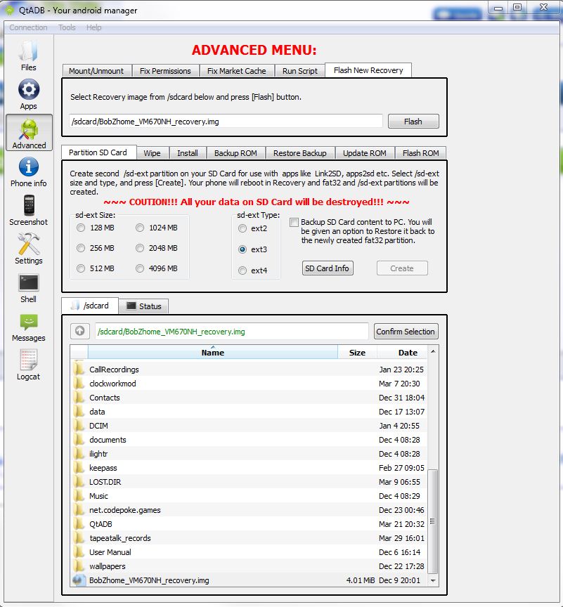

Boot in normal mode, browse files on the phone. If you can browse /cache partition you are good to go. You only need good recovery img file for your screen. QtADB comes with everything else.
Just drag and drop your recovery img from PC left pane to Phone /sdcard right pane. Then go to "Advanced" Page > "Flash New Recovery" tab, double click img file on /scard tab and press "Flash" button, reboot to recovery when prompted. If everything is OK you can flash ROM within the new recovery or using QtADB.

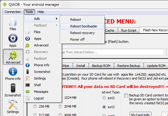

If you can't browse phone files, you can reboot to bootloader flash recovery with fastboot.
Reboot bootloader:
attachment.php
Press "Flash recovery" button, select recovery img file on your PC and wait a couple secconds. If you see message with no errors, it's done. Reboot phone (Tools>Fastboot>Reboot), then reboot to recovery and confirm it's OK. Then proceed with ROM.

OK. First go to "Flash New Recovery" tab and then double click img file.Do you see the full path typed in the box next to "Flash" button?
All this has to be done in normal Android OS, NOT in recovery.
It won't let me type in the box. But it says chose recovery image from/sd card below. And i used droid at screen and although i cant see it on the phone the cwm recovery is there and i can navigate throw it.
But you have wrong recovery for your screen.
You can't type in the box. You have to select img from sdcard bellow. Double click the img file there, or select it and press "Confirm Selection" button and it will be inserted in the box. Then you press "Flash".
Are you in Android OS or recovery? /sdcard and all functions except mount/unmount are disabled in recovery mode.
