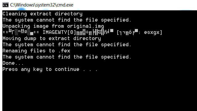

G'day all,
Yes, I think it may be the system image that's the problem.
I needed to use mkuserimg.sh but left it as raw. I will try again.
Also, I messed up the boot image by using abootimg instead of mkbootimg
Will post URL's in a few hours.
I am also creating a guide on how to do this here (WIP)
This is the result of following the guide on first part of placing the PP4MT-9 stock.img in the livesuite flash kitchen in packer ics folder renamed original.img.
There is no files in the output folder.
Any ideas as to why it doesn't work and how to correct ?
Cheers,
Craig
